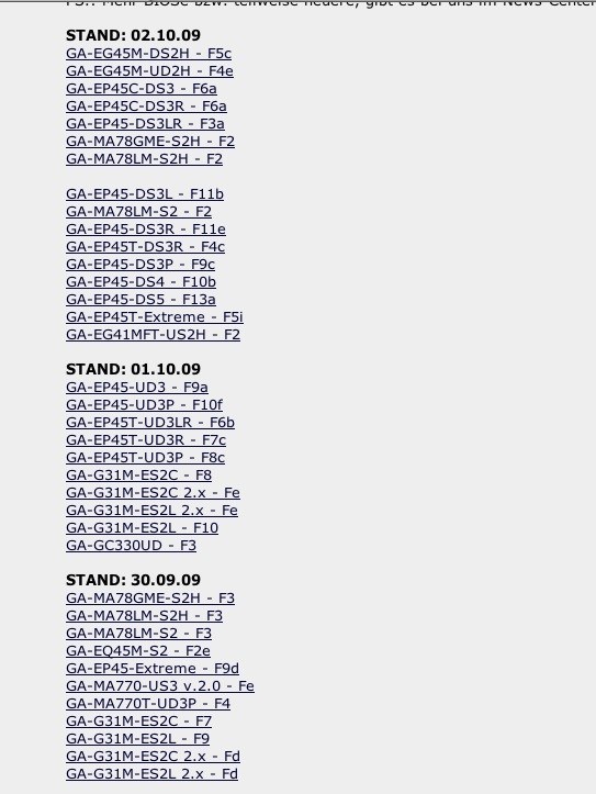

I added an link (as clickable safarie link - dl it unzip and double click) with most newest BIOS.
Screenshoot shows that latest changed last days : lot of new bioses.
Its german, but simple to understand - click on that bios you want
JZ_Board.zip
