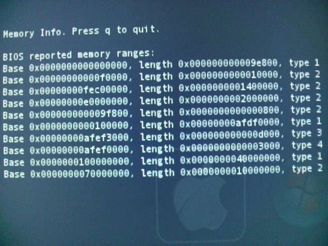

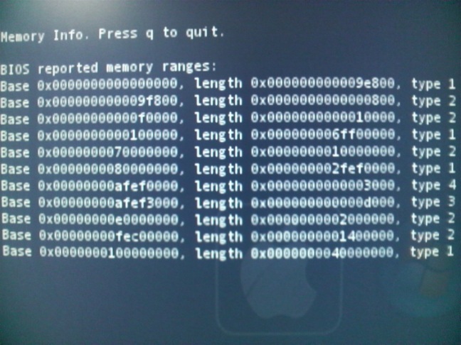

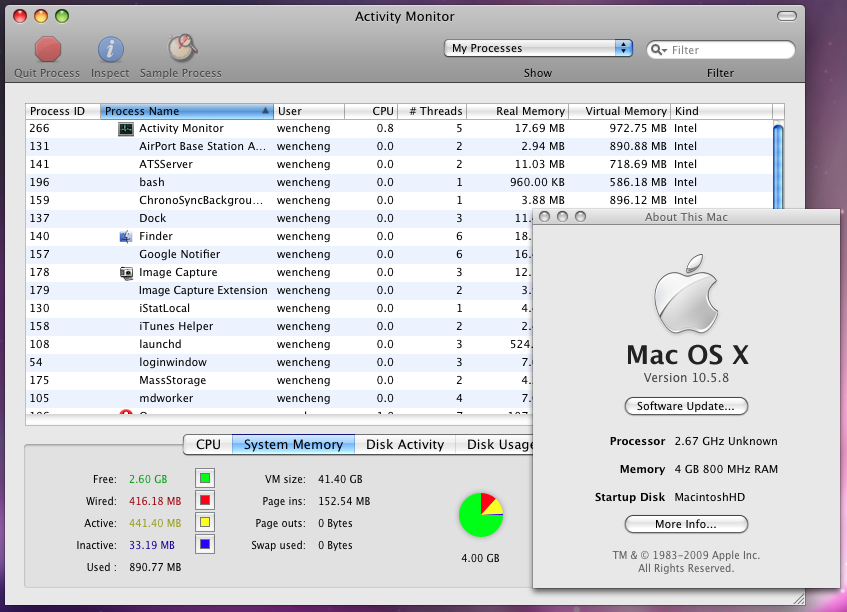

Hi all,
I have a GOOD NEWS...
Yes, yes, yes!
I got my >2G problem solved,
really.
at least at my e7aum@10.5.8.
My solution is "patch Chameleon",  to tell osx with the memory map we want.
I uploaded
  1. patch file for Chameleon 2.0 RC3 r658
  2. my patched Chameleon package for GMEM:256M,MEM:2Gx2(which i got)
  3. Chameleon's memory info before/after patching
  4. "About this mac" and "Active Monitor" after patching
  5. memtest which checks mem up to 4G
Future works:
  1. change hard-coding to configurable
  2. still missing some usable memory for unknown reason
AND finally greate thanks to dlach, for his(i'm sorry, if i'm wrong:-) awesome contributions in this topic.
256m_meminfo.patch.txt
Chameleon_2.0_RC3_r658_256m_patch.pkg.zip
mrosxn00b_memtest_max4g.zip

No, i patched Chameleon itself, the part of reading memory map from BIOS.  From patch file i uploaded, you can see some memory address is hard-coded in the source code that belongs to Chameleon.
Every OS read memory map from BIOS.  I digged into DSDT&SSDT@ACPI and i don't think it's easy (or safe, or even possible) to reset memory map after kernel is loaded which is required by dsdt patcher execution (Correct me if i'm wrong).  So the hardcoding idea came to me: Maybe >2G problem is just the overlapping in GIGABYTE's memory map (the overlapping can be confirmed from Chameleon's memory info, and this also explains why everything is ok if GMEM is mapped to 0xB0000000).  BTW, my thinkpad's memory map is clean which is sorted and without overlapping (NO OFFENCE to GIGABYE, i'm a chinese and i love taiwan).
Here is what i did:
  1. Find the part of reading memory by calling INT E820h
  2. So i got my target: biosfn.c
  3. Add a function in biosfn.c to do that
  4. 1) Split overlapped memory map (0x00100000:0xafdf0000)
  5. 2) Sort memory map
  6. Then, re-compile-package-install patched Chameleon
Everyone who has XCode can reproduce my procedure pretty easy on 10.5.x or 10.6.x, i think.  And, it's possible to migrate my code for GMEM:512M or MEM:>4G.

Dsdt
Dsdt patcher is loaded after reading memory map info, so dsdt patches (dsdt.aml) won't bother my patch.
The answer is: No, my patch does not need dsdt.
Bios version
I'm using Bios f3a by jon55 and tested that only.
But I don't think there are memory map difference between versions (see the mail from gigabyte that quoted by dlach: the difference is not mentioned by gigabyte).
The answer is: Yes, any patched bios will work which remains the original memory map info.
Osx version (theorically)
10.5.x and 10.6.x are using same loader (boot-132) which efi patcher and chameleon based on. Until the loader (especially, biosfn.c) become treating the overlapping like win&linux, my patch is necessary.
The answer is: Yes, it should works on 10.6.x. You can try it yourself, it won't take your much time.

You are welcome!!!
I was just about thinking of >4GB solution and the missing 256M (My Activity Console shows only 3.5GB usable mem).  Cos our mb supports memorys up to 16GB, i can't confirm every memory map proposition of memory amount.  So could you send me what Chameleon saying about your memory map? (Hit "Memory Info" at Chameleon's boot menu and then take a pic)
Becos of "Turbo Cache", which means that Windows nvidia driver takes twice of the gmem set in BIOS, it's ok for my win7 showing 3.5GB usable mem. Maybe BIOS reserved another 256M (in my case) somewhere for that. So i also need what win7 says about your usable memory, to insure you can use all of your 8G mems ;-) Pls send me your "Device Resources" report of EVEREST Ultimate Edition which is under the "Devices" node. See my attached report if you don't have any idea what the report is.
