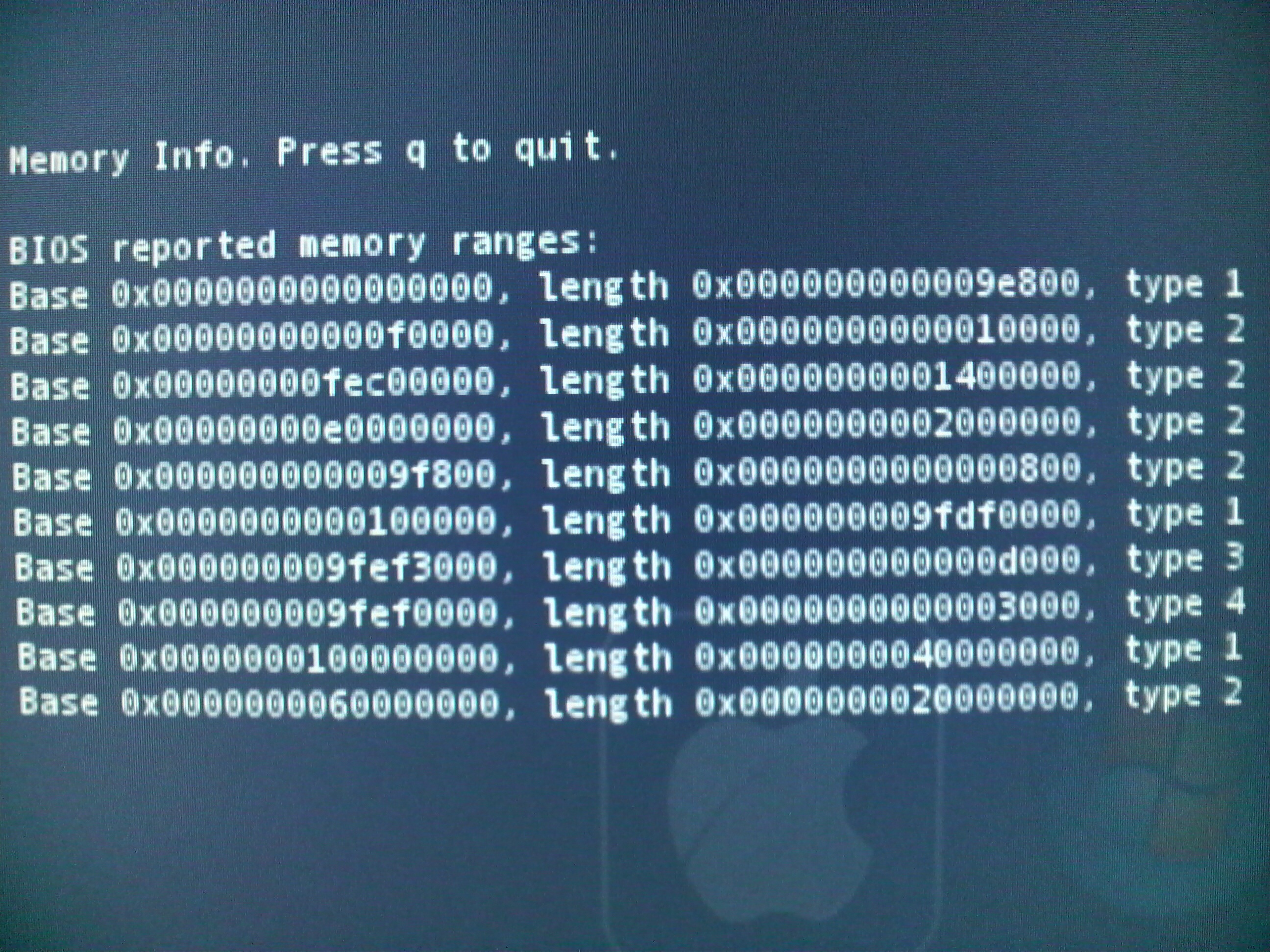

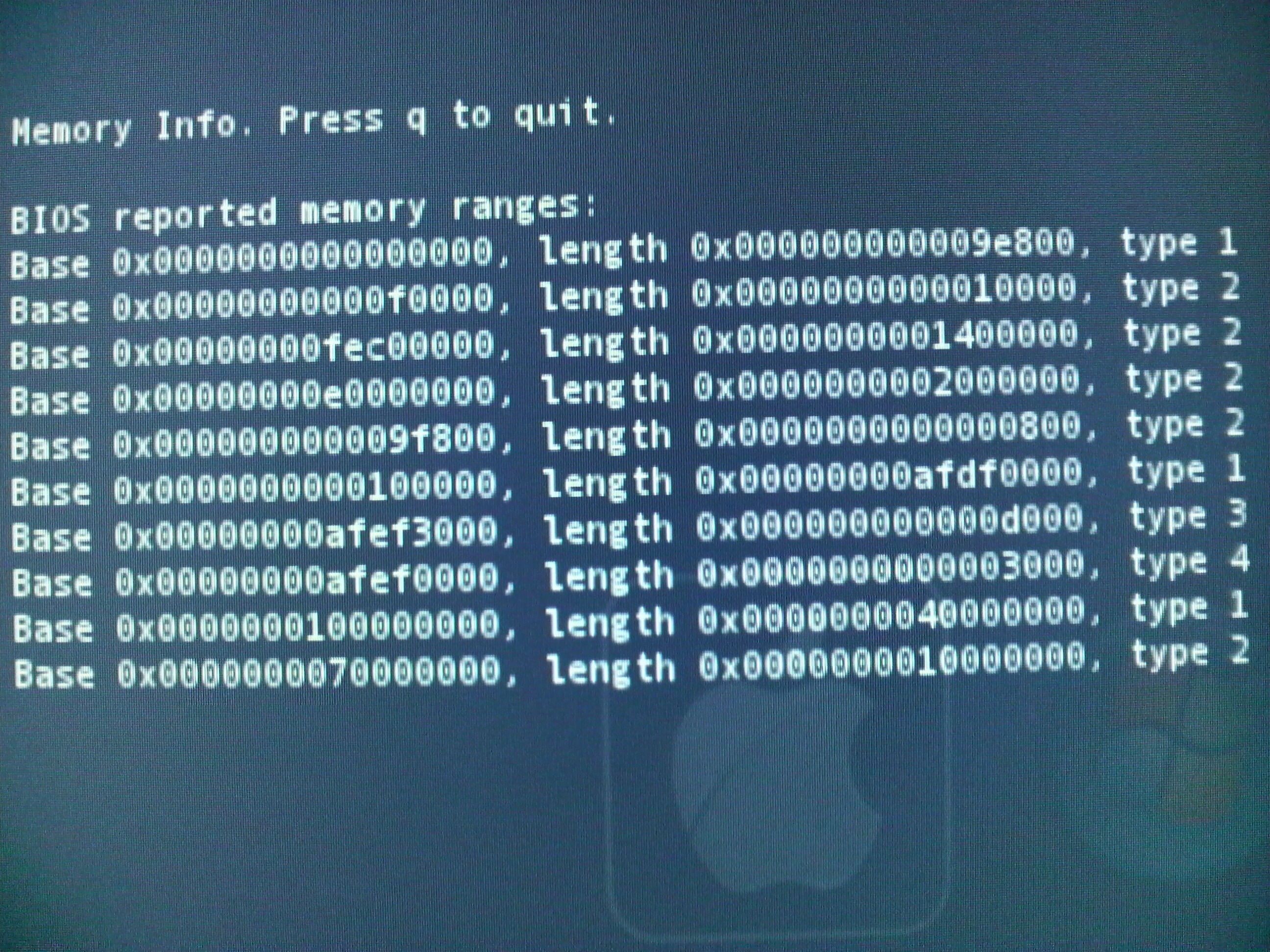

dlach Posted October 10, 2009 Author Share Posted October 10, 2009 I think its certainly worth asking Gigabyte. Have you dumped the memory table post bios with 2Gb and 2GB+ a really saw the diffence ( one dump with protection other without)? As this is a instruction from bios to cpu, there are two ways of fixing it. The obvious one is getting the bios fixed by Gigabyte, because the bios is responsible for protecting the memory. The other one is writing a kernel extention (.kext), that simply marks the region as protected. This is some what more difficult, as SL kernel source is closed. Finding the API is for memory mapper can be difficult. An other way to do this is to directly sending in structions to the cpu. The kernel dosn't take that much memory so and the .kext are loaded at boot time ( a little memory is used ). To produce a kext this will cost some effort, if i find someware some time i'll try to cook something. -X Since the MacBookPro with 9400 doesn't have a special kext, I don't believe we need one either. I suspect if I can patch that memory exclusion into our BIOS correctly it will just work. That said I did send essentially my post #147 to Gigabyte. Hopefully we'll get something useful back, if only advice. In the meantime I hope to get some time to work on it this weekend. As far as I can tell the section is question is standalone. I.E. I see no references to it anywhere in the DSDT. Perhaps I can just patch it in. Since the MacBookPro with 9400 doesn't have a special kext, I don't believe we need one either. I suspect if I can patch that memory exclusion into our BIOS correctly it will just work. That said I did send essentially my post #147 to Gigabyte. Hopefully we'll get something useful back, if only advice. In the meantime I hope to get some time to work on it this weekend. As far as I can tell the section is question is standalone. I.E. I see no references to it anywhere in the DSDT. Perhaps I can just patch it in. Errr Maybe not. Turns out the is the Global APCI memory region and it is where the BIOS passes info to ACPI. The good news is that I think they are specific to a chipset so maybe... Link to comment Share on other sites More sharing options...
