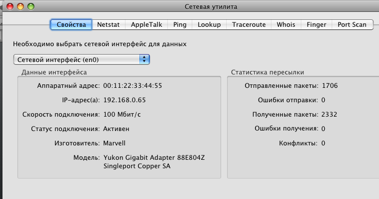

Thank you Adamsalac! The driver is working. This is a present to my birthday.
The small problem with Mac-address. I had
this address 00:11:22:33:44:55 is not good. What to do?

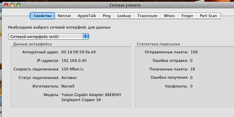

1. Kextload my beta driver Marvell.kext and look into system log
Nov 18 16:55:26 sergeys-macpro31 kernel[0]: Marvell: Ethernet address 00:1d:09:59:0e:e9
This is actual Mac address.
2. Open AppleYukon2.kext/Contents/MacOS/AppleYukon2 with HexEdit 2.0 (freeware).
At the picture you can see what and where
1AF20: C6 45 E2 00 C6 45 E3 11 C6 45 E4 22 C6 45 E5 33 C6 45 E6 44 C6 45 E7 55
Change these digits to your Mac-address, save and reboot. Now I see
I am happy!
