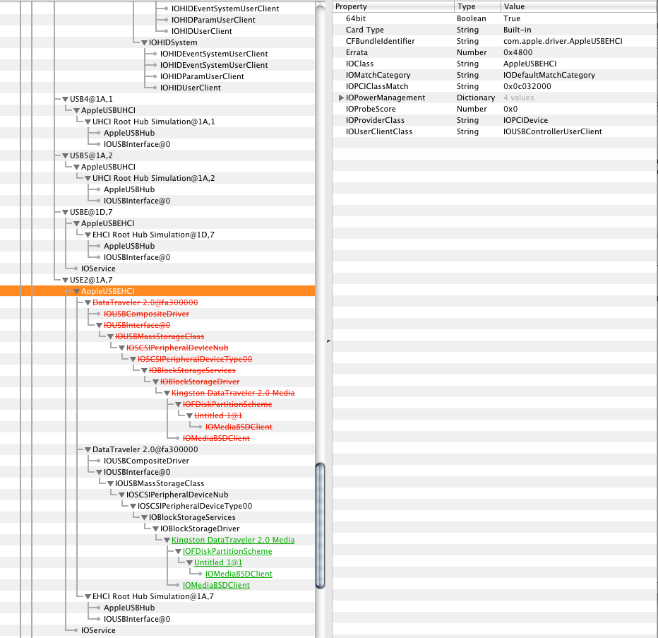

Please open IORegistryExplorer and go to the USB devices (probably have "USB" or "UHC" or "EHC" in their name).
Open up all the entries beneath it.
Then, unplug and replug a device and check if you see that there's now a red, stroken through entry and a green, underlined entry. If that is not the case, please surf the menus, there must be an option to enable that.
Then, go to sleep and wake up. You should see the same effect as above.
Compare the properties of the devices. Take a snap and post it here
Check the "Card Type", should be "Built-in", not "PCI". This corresponds to "Physical Location" in System Profiler, where "PCI"="Expansion Slot".
Also, go get the debug enabled USB KEXTs, they might just print the problem right to your system.log.
OK, I try this with EP45-UD3 and pcb355's patched USB kext installed after fresh reboot.
Yes I can see this:
No. I just get the same list as before sleep. There are no new entries in the list.
If I understood correctly this is not possible.
Done. The CardType is Built-in.
