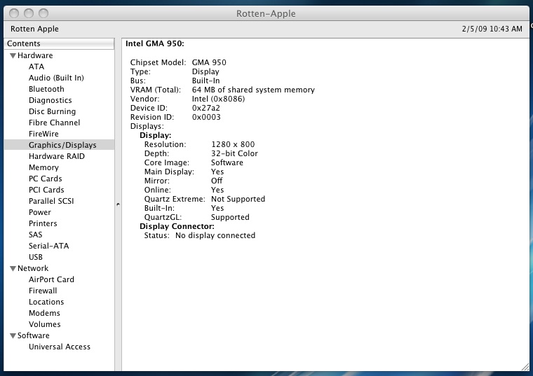

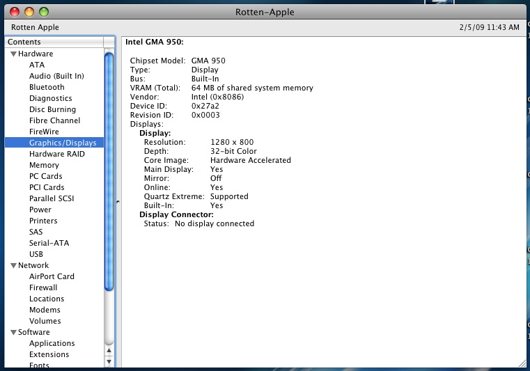

I tried the drivers, here is what happened...
I installed the GMA Kext and the Framebuffer KEXT for a total of 2 new kext files to be installed. I installed them with kexthelper. I did not touch the bundles (did not know what to do with them) or anything else in the zip file...
I rebooted and like you said it went black.. so i connected external monitor.
What i see is my desktop background only, it hangs there.
I booted in single user, and deleted the FrameBuffer KEXT, only. This brought me back in no problems, but no hardware accceleration @ 1024x768. Basically same as without driver.
Sometimes the screen goes black and then comes back, but thats the only real problem, apart from slow animation, no tears, or artifacts.
So thats where i am now. I think my main priority is the graphics... really not sure what to do about it next..

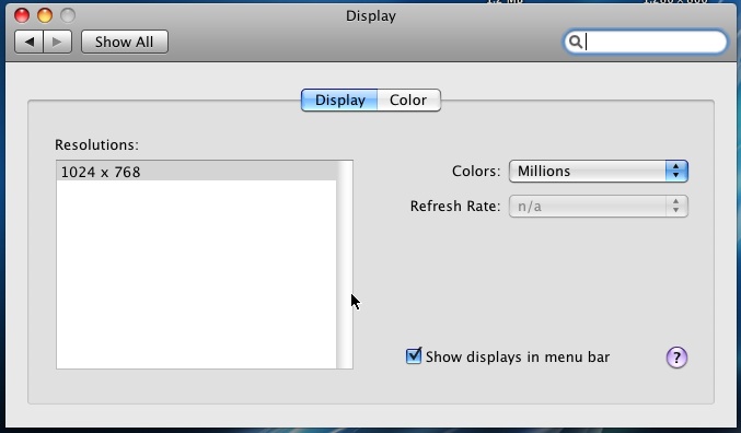

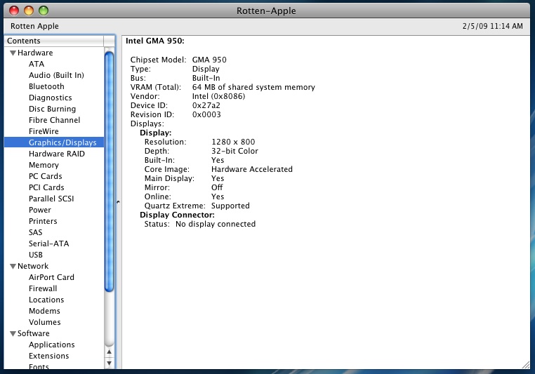

UPDATE : I installed the drivers from osx86Tools Hardware Update and i HAVE FULL RESOLUTION!!!!! ALL GOOD! I do not know whyyy this works over Sonotone or other manual methods
Moving on to other issues!

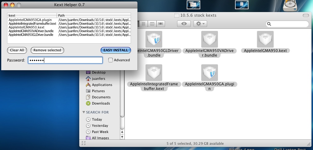

Prep: Kext Helper, type in the password and put in this file (InkBlot)
A terminal window: sudo su
then type in your password.
now enter the command:
while sleep 1; do rm -rf /System/Library/Extensions/AppleIntelCPUPowerManagement.kext; done
It will just sit there waiting to catch the kext and delete it, that's why you need to enter the su password.
Open Disk Utility.app and point to your installation Partition.
Now, here comes the fun part... with those 3 things open: terminal waiting, Kext Helper with password+kext and Disk Utility ready to go,
Install the update :blink: , when the updater finishes do NOT reboot, check if the terminal did the job by checking in /System/Library/Extension/ if you cannot find AppleIntelCPUPowerManagement.kext it did the job.
Install the missing kext to avoid having to connect a USB keyb+mouse
Repair permissions.

You will see a 1024x768 resolution, don't worry, unzip the stock drivers you downloaded earlier and install everything with Kext Helper, you may also want to install the 5 kexts you should have saved earlier.
System.kext
AppleACPIPlatform.kext
IONetworkingFamily.kext
seatbelt.kext
Repair reboot enjoy.

Graphics are working perfect, no tearing at the moment, sound is working great.
To test if your video is working as it should open the dashboard and add a widget with using the plus sign at the lower left corner, when you add just drag it to the screen, if it makes a "splash" animation when you throw it on the screen your video is good... if not install the drivers in this package taken from this post using Kext Helper repair permissions using disk utility (very important) then just reboot.
The files should be:
AppleIntelGMA950GLDriver.bundle
AppleIntelGMA950VADriver.bundle
AppleIntelGMA950.kext
AppleIntelIntegratedFramebuffer.kext
AppleIntelGMA950GA.plugin
To be honest, I know very little about driver tweaking in mac, but it worked for me.

everything perfectly smooth here. you need to make sure that you have full hardware support. find this under about this mac/more info.../Graphics/Displays
this is what it should look like
  Chipset Model:	GMA 950
 Type:	Display
 Bus:	Built-In
 VRAM (Total):	64 MB of shared system memory
 Vendor:	Intel (0x8086)
 Device ID:	0x27a2
 Revision ID:	0x0003
 Displays:
Display:
 Resolution:	1280 x 800
 Depth:	32-bit Color
 Core Image:	Hardware Accelerated
 Main Display:	Yes
 Mirror:	Off
 Online:	Yes
 Quartz Extreme:	Supported
 Built-In:	Yes
 QuartzGL:	Supported
Display Connector:
 Status:	No display connected
But, all your symptoms point to some different problem. It sounds like you got both cores running but with timing issues. are you sure you have either sonotone's patched kernel or the voodoo kernel? Only these two will allow you to run both cores without stuttering issues. also make sure that you have NO AppleIntelCPUmanagement. kext in your extensions. that kext will drive your cpu at 50% all the time.

Graphics are much smoother, still no hardware acceleration, but alot better. See GMA950 details below.
1395ABG just simply is a no go, from all posts i saw. Ordered 1390 from ebay for $12.
I have no artifacts, so not sure what to do about acceleration, guess i could do a DIFF on the drivers you gave me,
How exactly should i install them (including the bundles) not sure what to do as its not all kext files.
Intel GMA 950:
 Type:	Display
 Bus:	Built-In
 Device ID:	0x27a2
 Revision ID:	0x0003
 Displays:
Display:
 Resolution:	1280 x 800 @ 60 Hz
 Depth:	32-bit Color
 Built-In:	Yes
 Core Image:	Software
 Main Display:	Yes
 Mirror:	Off
 Online:	Yes
 Quartz Extreme:	Not Supported
Display Connector:

I took the time to take some screenshots of my GMA 950 on 10.5.5, 10.5.6 with the drivers from the postinstaller and 10.5.6 with stock drivers.
Check this out
This is 10.5.5 after installation.
After update 10.5.6 just the drivers from the postinstaller.
Stock kexts installation on 10.5.6
Now, 10.5.6 with stock kexts
