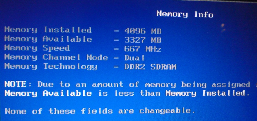

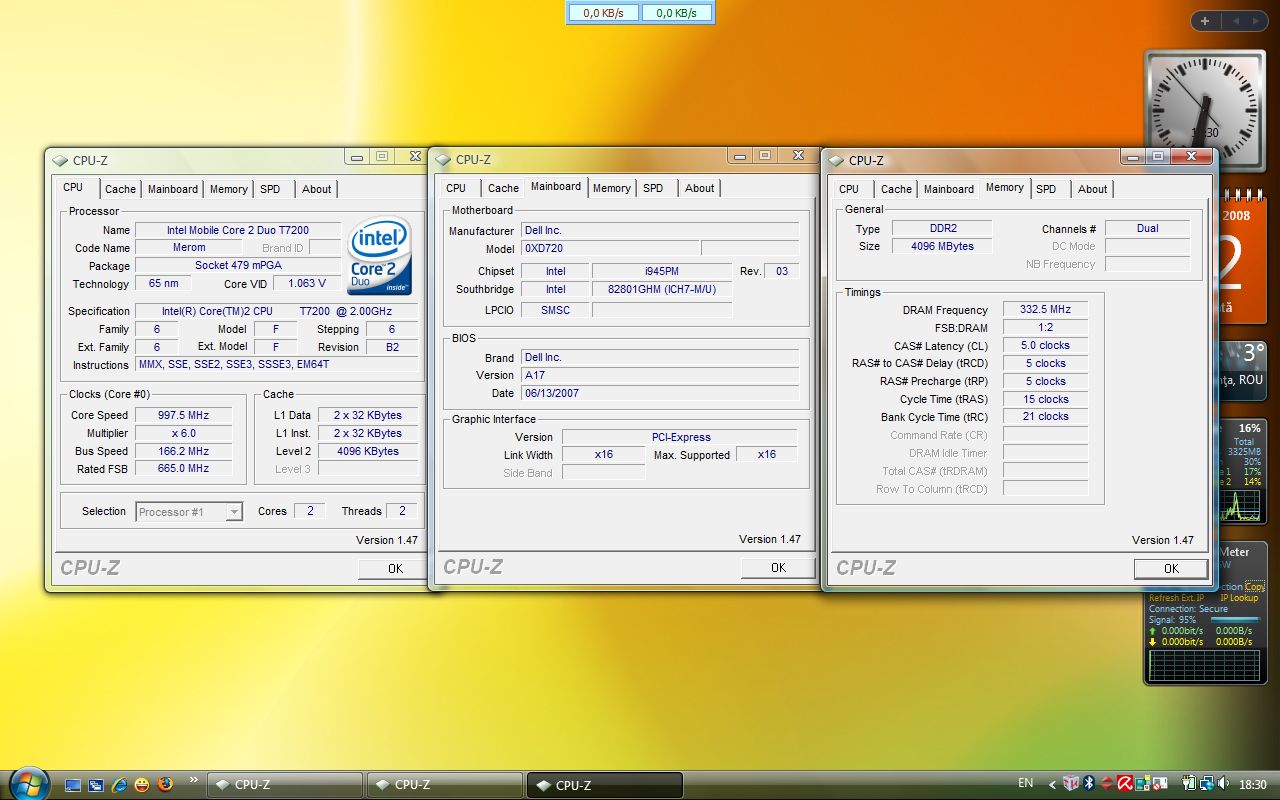

Missed a question.
The thing about the Inspiron E1505/6400 and the E1705 being limited to 2GB is a lie. You can install two 2GB DDR2 SODIMM's and it works fine. But unless you install a 64bit OS you will be limited to 3.3GB accessible. I have one of each model and have 4GB installed on each one
If you want 4GB go to newegg.com and search for "N82E16820231135" 4GB for $39.99 with free shipping and works perfectly in the E1505/E1705 Inspirons.
:D
holy {censored}, when I installed the memory it didn't boot at all, just a bunch of blinking lights and nothing. I tried all kinds of combinations with new set and old set. nothing worked. I then installed only one of the new modules. system booted fine. I figured it doesn't work above 2Gb. then I added the second module and the system finally posted with an error that system memory changed. Still nothing happened after that. I rebooted a few times and all of a sudden it would allow me to hit F1 to continue. Since then the system boots fine with all 4Gb recognized (Vista 64).
wow, thank you so much for this tip sccarlso, now you are my hero ;). Not sure how to explain the above behavior, but in the end I don't care - it's working great. btw. I got the more expensive ram with 4-4-4-12 timing (supposed to be a little better than latency 5). Of course right after I bought that they had the same deal back that you got.

Here is an update for me.
-Got both cores working with Sonotones Dell Post Installer V1.3
-Bought 4 Gigs of RAM from Newegg and in BIOS it says only 3.3GB is being used but in Leopard it says 4GB of RAM...so I'm guessing it is using all 4GB?

I figure I'll post this in here because I'm not sure how many people read my post in the Marketplace about it, and I've sent messages to like five people already about it.
The trick to finding the GeForce Go 7300 on eBay is searching by the Dell part number "NJ887", otherwise you'll just come up with some case badges. Searching NJ887 will find you a bunch of cards, around the 40-50 dollar range.
it's not about hacking here, it is just bad report from dell.
also I've instalated 2x2G 667Mhz, corsair memory module and it's working, but with limitation.
If u go in bios u will see memory installed 4097MB and available 3327MB :( ....I think is dell restriction, why I said this, because my mother board chipset is Intel i945PM and on Intel website it seems this chpset supports max 4GB memory...
so if u have 945 chipset from intel also will work on your "toy" :D
later edit. . .
but the os seems to see all memory installed, but it works with just 3,325GB(available)
good lock!!
how the hack did you install 4Gb of memory? I thought the E1505s only take 2Gb according to Dell specs.
