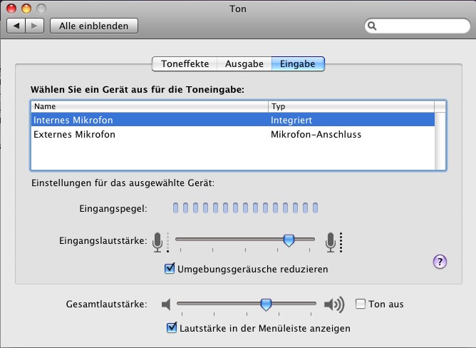

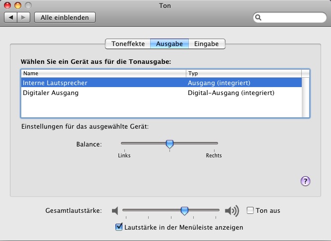

Acid_Burn Posted March 28, 2009 Share Posted March 28, 2009 MSI ich7 alc888s driver. version 0.1 beta. Report any bug. One possible bug is that it may not load properly sometimes. Just restart and see. - Delete appleazalia kext, then install new kext, delete extensions.mkext - restart - Audio Output and Mic Input shows in Sys Preferences / Sound. - Audio shows in Sys Profiler - Audio-Switch Internal Speaker --> Headfones o.k. - BUT: No Sound, no Mic works... Link to comment Share on other sites More sharing options...

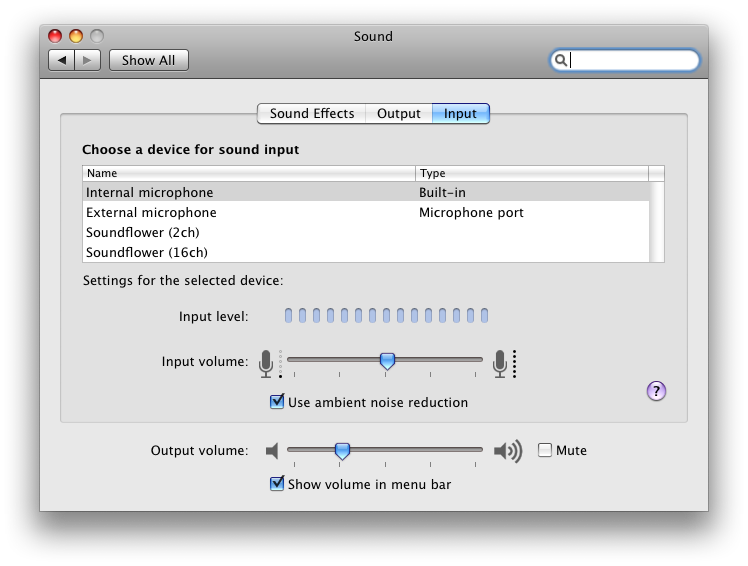

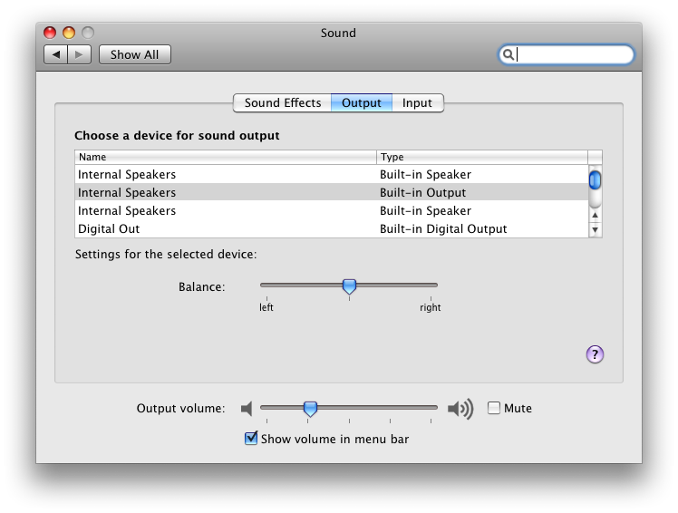

cnnn Posted April 10, 2009 Author Share Posted April 10, 2009 I'm not familiar with Chamelon bootloader. I think it's a little bit difficult to use than boot-132 since it needs dsdt.aml...??? I have updated the kexts for msi, set MuteGPIO to 0 for those who can see audio in system pref, and made another one named 888s0.31.kext according to brule's. - Delete appleazalia kext, then install new kext, delete extensions.mkext- restart - Audio Output and Mic Input shows in Sys Preferences / Sound. - Audio shows in Sys Profiler - Audio-Switch Internal Speaker --> Headfones o.k. - BUT: No Sound, no Mic works... The MuteGPIO may cause this. Give v0.3 a try. Y510 (same audio setup as the Y530), wasn't able to get anything to work beyond what I already had working (which is just basic audio out).I'm running JaS 10.5.4 and has since been updated to 10.5.5, haven't bothered with 10.5.6 yet. How should I be installing this? 1055 is fine. Are you sure it has the same pathmap with 530? Please post the pathmap here. mine <01471c40 01471d41 01471e13 01471f01 01571c20 01571d11 01571e13 01571f01 01671c30 01671d61 01671e13 01671f01 01871c10 01871d90 01871ea1 01871f01 01971c60 01971d01 01971ea0 01971f90 01b71c70 01b71d40 01b71e21 01b71f01 01e71c50 01e71d11 01e71e4b 01e71f01 01f71cf0 01f71d11 01f71ecb 01f71f01> 0.33 <01171c40 01171d11 01171e4b 01171f01 01471c10 01471d40 01471e21 01471f01 01871c20 01871d90 01871ea1 01871f01 01971c30 01971d01 01971ea0 01971f90 01b71c50 01b71d11 01b71e13 01b71f01 01e71c60 01e71d11 01e71e4b 01e71f01 01f71cf0 01f71d11 01f71ecb 01f71e01> Link to comment Share on other sites More sharing options...
Acid_Burn Posted April 11, 2009 Share Posted April 11, 2009 MSI ich7 alc888s driver. version 0.31(based on brule's;and version 0.3 and 0.3rev for the rest). Report any bug. One possible bug is that it may not load properly sometimes IN 1056. Just restart and see. 1.) Test: alc888s-0.31 brul = don´t work 2.) Test: alc888s-0.3rev = don´t work 3.) Test: alc888s-0.3 = don´t work On all Test´s: Sound output (Headfone+internal Speaker) shows on sysprefs/sound On all Test´s: Microphon shows on sysprefs/sound but no Mic and no Sound works.... see log... log_11.4.09.rtf Link to comment Share on other sites More sharing options...
