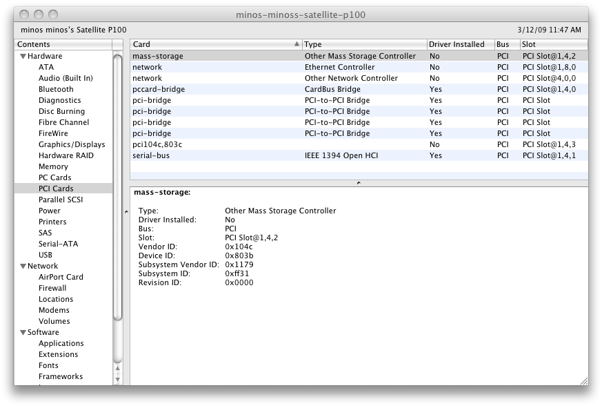

jazzminos Posted March 11, 2009 Share Posted March 11, 2009 to mrigank Absolutely NO success I have the same device/vendor id as You have... I have upgraded from 10.5.5 iATKOS to 10.5.6 same as You did. But nothing helps - "cable unplugged" message is all I have. It seems that there is no universally working solution I did ALLthe steps You did: deleted kexts, deleted Extensions.mkext, repaired permissions at EVERY step, even cleared all possible caches with OnyX. Nothing helps. Kext has "loaded" state... But something doesn't work. When I tried this for the first time I thought that the problem is with the kernel (I had Voodoo kernel), but now I did everything with stock kernel... I updated CardBus/PCMCIA PC Cards for Leopard... But... no success at all. to morane Some of the problems are solved here http://www.insanelymac.com/forum/index.php?showtopic=81036 We are waiting for WiFi here: http://www.insanelymac.com/forum/index.php...amp;start=3320# Link to comment Share on other sites More sharing options...
mrigank Posted March 11, 2009 Share Posted March 11, 2009 To jazzminos Have you tried to boot with -f.In my case when I was booting with -f it was some time working some time not then I checked extension loaded.as we don't need AppleIntel8254XEthernet.kext.Do check out if this kext is loaded as if this is loaded then ethernet would not work. Try to check which slot your card is using.below link will help as mine was also not working. To morane Try this thread for PCIMCIA http://www.insanelymac.com/forum/index.php...1036&st=500 Link to comment Share on other sites More sharing options...
jazzminos Posted March 12, 2009 Share Posted March 12, 2009 No success... But let's look at the picture. PCI information tells us that system knows about Ethernet adapter, but NO DRIVER LOADED! Link to comment Share on other sites More sharing options...
kizwan Posted March 12, 2009 Share Posted March 12, 2009 No success... But let's look at the picture. PCI information tells us that system knows about Ethernet adapter, but NO DRIVER LOADED! Hi jazzminos, Where do you put the AppleIntel8255x.kext file? Was it in this directory:- (1) /System/Library/Extensions/ or (2) /System/Library/Extensions/IONetworkingFamily.kext/Contents/PlugIns/ If you put in (1), did you remove the original AppleIntel8255x.kext located in (2)? Try to load manually while you're in OS X:- kextload -tv /System/Library/Extensions/AppleIntel8255x.kext or kextload -tv /System/Library/Extensions/IONetworkingFamily.kext/Contents/PlugIns/AppleIntel8255x.kext Post the message back here. Good luck. kizwan Link to comment Share on other sites More sharing options...
jazzminos Posted March 13, 2009 Share Posted March 13, 2009 Hi! Thanks for reply. Where do you put the AppleIntel8255x.kext file? Was it in this directory:-(1) /System/Library/Extensions/ or (2) /System/Library/Extensions/IONetworkingFamily.kext/Contents/PlugIns/ I tried both. If you put in (1), did you remove the original AppleIntel8255x.kext located in (2)? Yes, I did it. Try to load manually while you're in OS X:-kextload -tv /System/Library/Extensions/AppleIntel8255x.kext or kextload -tv /System/Library/Extensions/IONetworkingFamily.kext/Contents/PlugIns/AppleIntel8255x.kext The result is the same in both cases. BUT in case I load AppleIntel8255x.kext included in IONetworkingFamily.kext it is not located in loaded extensions in System Profiler. And when I load it individually it exists in the loaded extensions list. I attach results of manual loading. I suppose that problems may happen because of some drivers in Power management... I'll try to install PowerManagement.bundle... Patched one may have been replaced during update. With great respect, jazzminos. Terminal_Saved_Output1.txt Link to comment Share on other sites More sharing options...
kizwan Posted March 13, 2009 Share Posted March 13, 2009 ................. I attach results of manual loading. I suppose that problems may happen because of some drivers in Power management... I'll try to install PowerManagement.bundle... Patched one may have been replaced during update. With great respect, jazzminos. Hi jazzminos, It look like there is no problem with dependencies. Can you try this one last thing? I need you to boot with "-s" (singe-user mode) & when the terminal prompt appear, please input this commands (press Enter after each command):- mount -uw / rm -rf /System/Library/Extensions.mkext kextcache -a i386 -m /System/Library/Extensions.mkext /System/Library/Extensions reboot This is to rebuild Extensions.mkext. After reboot, please open Terminal program & execute this commands:- sudo -s dmesg > ~/Desktop/dmesg_jazzminos.txt Post that file back here. If you want, you can include screenshot of your System Profiler (Extensions). Thank you. kizwan Link to comment Share on other sites More sharing options...
