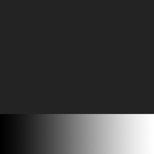

arturv Posted May 15, 2006 Share Posted May 15, 2006 I attached the image that demonstrates the problem. Interesting to note that on dual monitor setup there is no dithering on secondary screen. So video card and drivers under Windows are quite capable to deliver true colors. It almost seems like LCD screen needs proper drivers. I suspect, that it happens during windows booting since thats when video is set to 16bit first (during Windows Logo) and for some reason it doesnt come out of it. Link to comment Share on other sites More sharing options...
