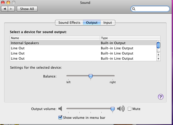

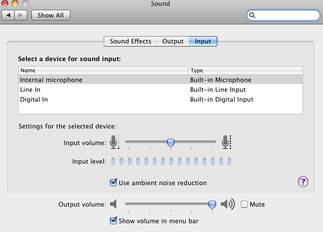

anybody got front/back headphones and mic working?
Works for me with HDA Enabler 1.0.0d1 and Legacy HDA.

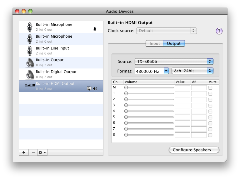

I'm another 662 user trying to get HDMI audio working. I'm using an Acer Aspire Revo r3610. I've attached my current DSDT.aml. It's being used with a kext called ALC662.kext which I believe was originally made for one of the Zotac machines. My current setup shows an extra input and output but works just fine otherwise. I tried adding the relevant parts to my DSDT but no luck. My device id is 0007 as someone else with a 662 also mentioned. Any help with this would be brilliant, thanks.
Marc
Revo.zip

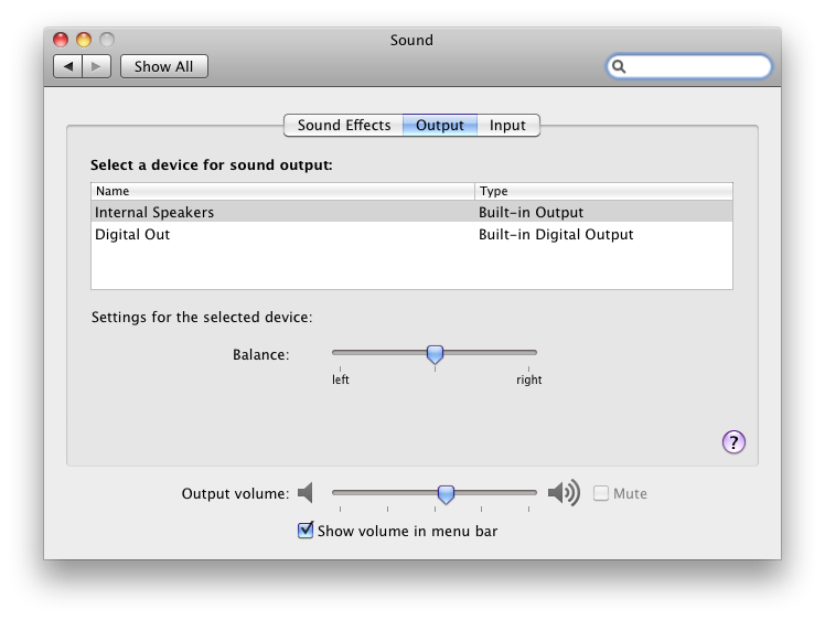

I only need spdif out - nothing else -, cause I am using an external
studio dac (rme-adi 2) feeding 2 Adam Studio monitors.
voodoohda works with spdif out but only in 16 bit mode /44Khz -192KHz
not in 24 bit and without dynamic samplerate changing
is there any chance with the ALC 889 stuff here ?
I mean a working SPDIF out 24 bit 44 ,1 -192 Khz ?
Thanx
Armin

Yes: 889A and
solved (24bit/96khz SPDIF out)
thanx for the tip
best
a

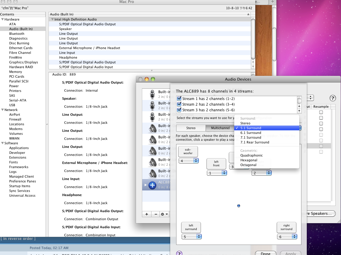

GA-x58A-UD3R ALC889 to 5.1 and 7.1 4x Lineout, 2x Mic, 1x LineIn, 1x Digital In/Out good :D

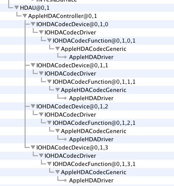

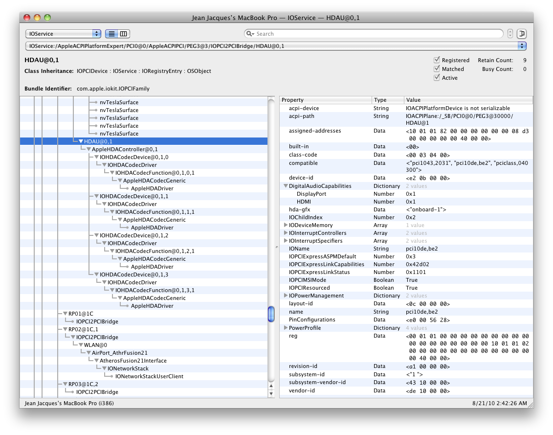

I'm trying to get HDMI sound on a GTX 480.
I've followed tmongkol guide for HDAU injection and the beginning is pretty good:
Not patched:
Sound assertion ""hda-gfx property indicates support expected but vendor & product ID are not known to driver!\\n"" failed in "/SourceCache/AppleHDA/AppleHDA-187.4.1/AppleHDAController/AppleHDAController.cpp" at line 661 goto handler
Patched 000a -> 0010 (got the ID under windows):
Patched AppleHDAController from 0eb4 to 0eb5 (Fermi High definition audio):
When no cable no error message and kext loaded:
78 1 0xffffff7f81355000 0x17000 0x17000 com.apple.driver.AppleHDAController (1.8.7f1) <77 58 9 5 4 3 1>
101 0 0xffffff7f8146d000 0xc4000 0xc4000 com.apple.driver.AppleHDA (1.8.7f1) <100 78 77 73 59 58 5 4 3 1>
When i put an HDMI cable i've got this error :D
Sound assertion ""Graphics vendor property indicates CODEC is attached but
Presence Detect is FALSE!\\n"" failed in
"/SourceCache/AppleHDA/AppleHDA-187.4.1/AppleHDA/AppleHDADriver.cpp" at line
3614 goto handler
3614 goto handler
Help ? :blink:

Before you connected an HDMI cable, did you get HDAU like the below picture?
Why did you have to patch HDAController binary? I didn't have to do anything about HDAContoller for my GT220 & GT240. I patched AppleHDA bin for GT240 only. Did you try edit info.plist of AppleHDAController.kext?
I am thinking that AppleHDA will not support fermi/GF100 since there are no official GF100 kexts from Apple.
@ zzebulonn
Yes exactly that one.

GOT IT!!!!
On Nvidia GT240M.
Tmongkol, thank you so much for your guidance!!

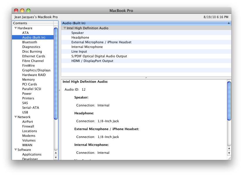

Looking at the IORegistryExplorer of the newer MacBookPro6,1, I discovered there's some important clues going on with the AppleHDAController kext.
The MacBookPro6,1 uses the device id 0BE2 for the Nvidia HDMI audio, same Nvidia HDMI id as mine, that's why I did not get any HDMI audio device id errors. The device id 0BE2 is in the AppleHDAController binary.

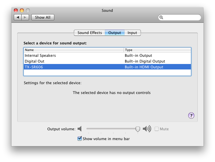

*** EDIT - 27 Aug 2010 ***: I now get HDMI audio, including all the other sound devices in Sound preferences. I had combined 2 microphones in the AppleHDAPlatformDriver Pathmaps, now I have the 2 microphones in 2 separates Pathmaps. The hdaGfxCandidate failed error is gone. HDMI audio is enabled with dsdt edit only. AppleHDAController totally unmodified.
The HDMI is connected to my Onkyo TX-SR606 audio receiver. I can do up to 7.1 multichannel, or send directly the Dolby Digital 5.1 encoded stream in VLC Media Player by selecting Built-In HDMI Output (Encoded Output).
I tried the 5.1 AAC encoded Apple trailer of Skyline. Crisp, neat and vibrant 5.1 analog sound coming out of all 5 speakers and the subwoofer. Quite neat.
Thanks again Tmongkol.
