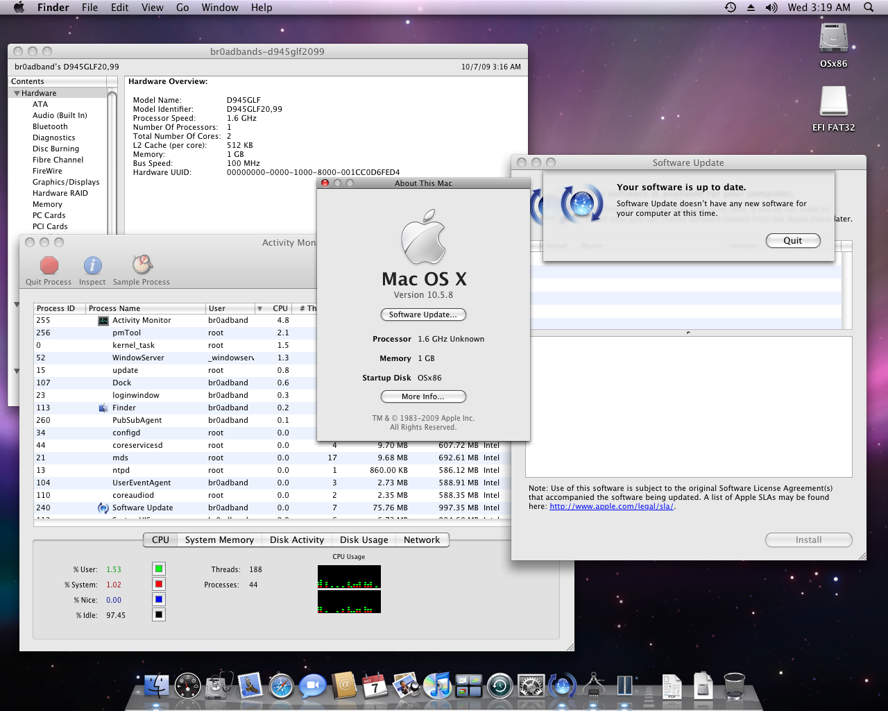

Been away from the OSx86 scene of late but decided to get back into it because I acquired a 16GB iPhone 2G at a pawn shop recently for a fantastic price. Now my focus is on potentially creating an app or two for the App Store so, that means it's time to put together yet another Hackintosh.
I read through this thread a few times and decided to grab a D945GCLF2D (yes, the non-S-Video version) and get to work. 1GB of DDR2 667 (running at 533), an old Maxtor SATA I 250GB 16MB 7200 rpm drive (yes, SATA I), a Lite-On iHAP322 optical drive, a cheap power supply, and a simple cheap USB keyboard and Microsoft Optical mouse, that's it. It's actually laid out on my bed (all of it) and hooked up to my Sony G400 19" CRT. BIOS is at defaults meaning HT is enabled.
I'm currently running 10.5.8 and it's fully updated with nothing but:
- the installation of 10.5.6 retail using Onetrack's rEFIt method, no issues to speak of. One tip: you should run the makeusb.bat file inside an Administrative Command Prompt. That is what it requires on Vista or Windows 7 - with XP it shouldn't be an issue but I wouldn't touch XP anymore if someone paid me. But anyway, do it from inside an Admin Command Prompt and it takes less than 5 seconds, no errors whatsoever.
- once the installation was finished, reboot as required, remove the DVD from the optical drive, choose the hard drive in rEFIt, boot into 10.5.6 and verify everything is working. NIC works - I don't see the need for the RealtekR1000.kext patch, the NIC works by default (at least for me), but audio was dead. Downloaded Kext Helper b7 and installed it, copied the AppleAzaliaAudio.kext from the USB stick (EFI FAT32) to the Desktop, installed it with Kext Helper, rebooted, audio works.
- at this point I have a fully working native retail 10.5.6 - and it all works without one single issue, even the audio at that point. DVD player works, GMA950 is flawless (little laggy but, hey people, this is an Atom, it's not meant to be a monster processing machine, just a low power high efficiency alternative).
- I thought about installing the 10.5.7 combo update but I knew from reading these posts that I'd end up disabling HT - could care less about that at this moment so, instead of 10.5.7, I decided to jump directly to the 10.5.8 combo update. Downloaded it, installed it, rebooted - with HT enabled - and course instant kernel panic (hey, I had to try anyway, can't learn nothing unless you do it yourself). Rebooted, reset BIOS to HT disabled, rebooted, bam, I'm starting at the fully functional 10.5.8 Destkop.
But I ain't done yet. :D
- I decided to go ahead and do a full Software Update, everything that's currently available and see what happens. Grabbed everything available, installed it, rebooted, voila... as the picture shows.
I don't understand how some people are having so many problems with the basic 10.5.6 install that Onetrack put together, and the tools he threw together to make the USB stick - and I've got no beef leaving a USB stick plugged in, they're so cheap I could go buy 10 1GB sticks for less than $20 these days if I tried. Onetrack's instructions are crystal clear and not really open for a bunch of interpretation - do what he explains step by step, you get the same results (unless your hardware is defective, of course).
But at this moment, I'm staring at a 10.5.8 fully functional Hackintosh. Once again, I'm running OSx86 just as I was way back in 2005 when this whole project got started (was using a Dell P4 laptop in those days). It's been a long time but it's nice to see things are a bit easier and the hardware works even better since I helped start all this stuff get rolling.
Not sure what else I can show in the screenshot but, here it is... good luck, folks, I've got some iPhone programming to get started on. :D

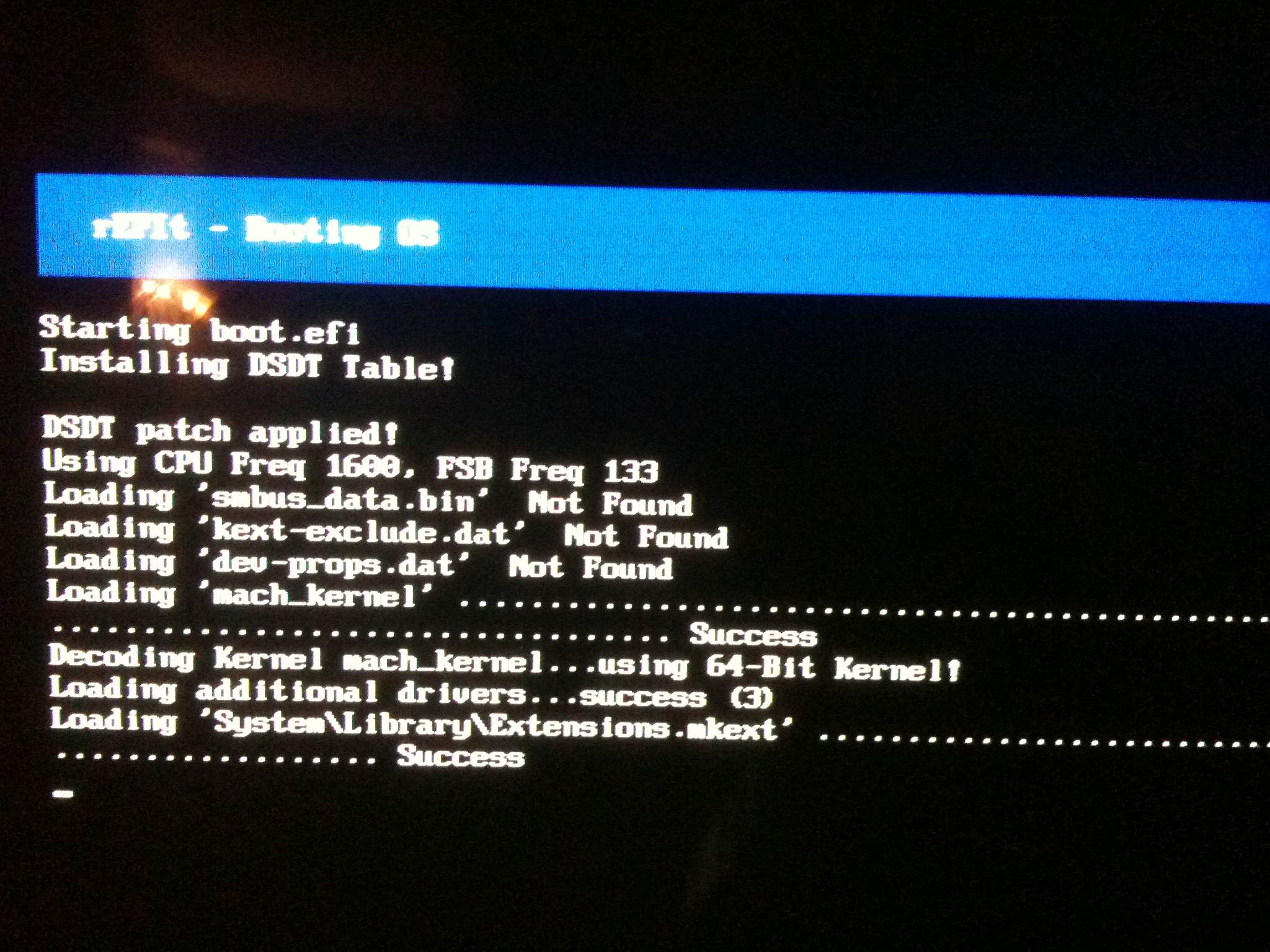

One request: As this rEFIt method is new to me and I can't quite figure out how to stop it from booting in "verbose mode" from the rEFIt website, could someone help all us n00bs and give us a heads up?
I found the refit.conf file and changed the timeout length but I'm at a lose and have read the whole thread looking for any evidence for Onetrack's followup to the "we will change this later" comment in the guide... haven't found any.
my machine is works a treat, but I really would love to give all that scrolling text the axe, ya know? Thanks!
