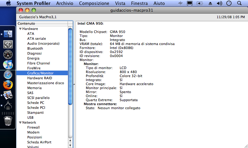

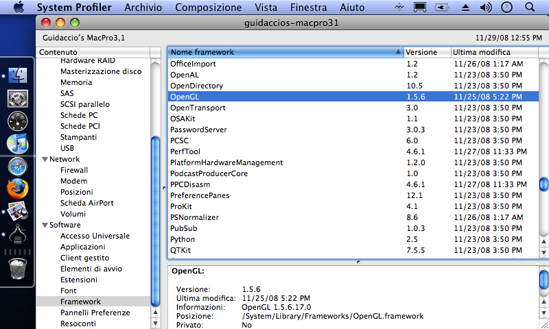

Install GMA900 and OpenGL.framework
Unpack GMA900NOPAPERCLIP.zip
Unpack all zipped extensions inside GMA900 folder and install them with Kext Helper but not reboot immediately.
Backup your OpenGL.framework /System/Library/Frameworks/OpenGL.framework
Download http://kindred.at/maci/OpenGL.framework.tar.gz and extract to your Desktop
Open Terminal:
su -
rm -r /System/Library/Frameworks/OpenGL.framework/Versions/A
mv /Users/"yourusername"/Desktop/OpenGL.framework/Versions/A /System/Library/Frameworks/OpenGL.framework/Versions/
chown -R root:wheel /System/Library/Frameworks/OpenGL.framework
remember to replace ONLY the A folder or the GMA900 starts without QE/CI Hardware Accellerated!
Attach the USB HD to your EEEPC select boot menu and start from USB HD using -v -f boot flags
If the graphic card extensions is loaded correctly you have all things working webcam with PhotoBoot, FrontRow, ScreenSaver, Dual Head, Mirroring on external monitor working but with the same resolution of the eeePC

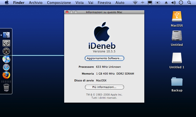

Screenshoots..

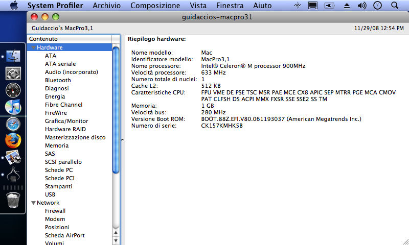

Sleep with this kernel works perfectly!
System profiler say 633 Mhz..

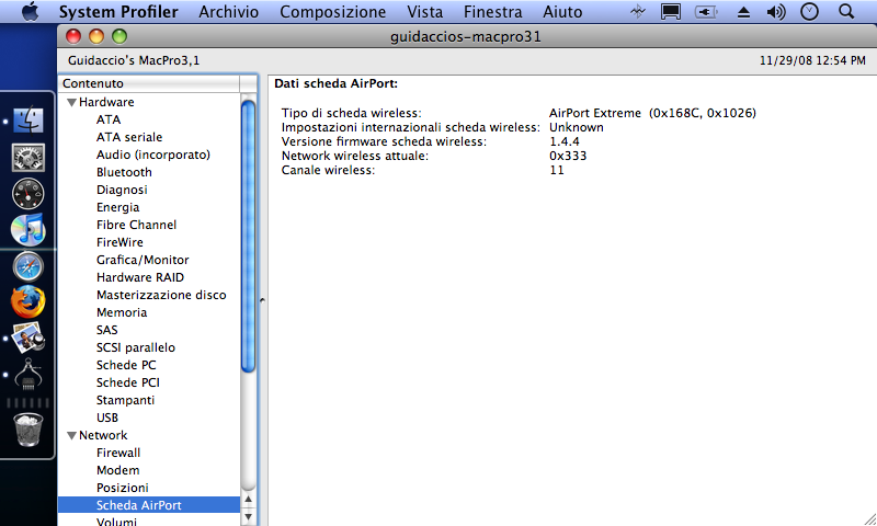

The Wireless in my office with a Zyxel 802.11a/b/g works perfectly
WPA-PSK auth works
After Wireless Kext installation sometimes at boot you can have a kernel panic simply reboot
At my home sometimes the networks goes down but i have a Netgear ME103 802.11b AP i will do other tests.

If you want to monitor your airport from cmd line
ln -s /System/Library/PrivateFrameworks/Apple80211.framework/Versions/Current/Resources/airport /usr/sbin/airport
guidaccios-macpro31:~ guidaccio$ airport -I
agrCtlRSSI: -56
agrExtRSSI: 0
agrCtlNoise: -94
agrExtNoise: 0
state: running
op mode: station
lastTxRate: 54
maxRate: 54
lastAssocStatus: 0
802.11 auth: open
link auth: wpa-psk
BSSID: 0:13:49:71:e:bf
SSID: Skynner
MCS: -1
channel: 13
