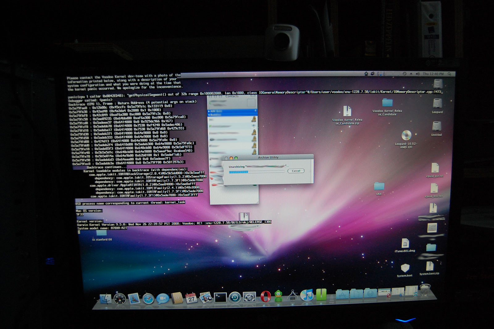

howarchaic Posted November 27, 2008 Share Posted November 27, 2008 KP while extracting huge archive http://farm4.static.flickr.com/3234/306464...c38dd2998_b.jpg Couldn't get the forum uploader to work... Link to comment Share on other sites More sharing options...

howarchaic Posted November 28, 2008 Share Posted November 28, 2008 A better shot of my KP... Any help would be amazing as I think this would also help with my other problem of not being able to use the burning function of my sata burner... Link to comment Share on other sites More sharing options...
Dense Posted November 28, 2008 Share Posted November 28, 2008 A better shot of my KP... Any help would be amazing as I think this would also help with my other problem of not being able to use the burning function of my sata burner... This problem is due to the IDE kext not handling 4G of ram. Set your maxmem to 2048 and you should see the problem go away. You will need a more current IDE driver to get around the problem. Link to comment Share on other sites More sharing options...
mercurysquad Posted November 28, 2008 Author Share Posted November 28, 2008 A better shot of my KP... Any help would be amazing as I think this would also help with my other problem of not being able to use the burning function of my sata burner... You need updated ATA driver (look few posts above yours). Link to comment Share on other sites More sharing options...
