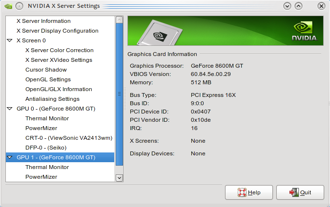

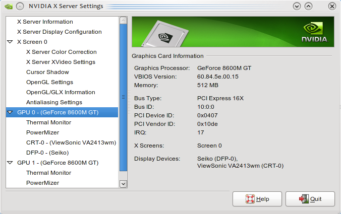

DVSoftware Posted August 11, 2009 Share Posted August 11, 2009 I just have hdmi out, but don't have any monitor with hdmi input nor any convertor handy... I'm too affraid to flash the card Linux reports different things, maybe we can use that info... in fact it shows that both cards have 512mb (i think they share it, but probably a mistake putting 256 mb in nvinject, though shouldn't affect dual monitors)... And it shows both monitors on a same card... I guess second card handles hdmi and s-video Link to comment Share on other sites More sharing options...
ludacrisvp Posted August 11, 2009 Author Share Posted August 11, 2009 Well under windows each card only shows 256mb and that is how Toshiba advertises the laptop in the fine print. Its a dual GPU totaling 512mb of VRAM. I am also running the 256mb nvinject, others are also running that same version. I suppose its possible that one card runs VGA and internal connection and the other runs HDMI and S-Video. Link to comment Share on other sites More sharing options...

steenamaroo Posted August 12, 2009 Share Posted August 12, 2009 Phew... i guess i'll also try older nvinjects later today... i think there are some different versions of nvinjects with dual cards support... Edit: Just 0.2.1. works... boot into dos and use nvflash i think the command is nvflash --list or something like that, google it! it'll list both your cards, dev ids and ram amounts....i hope. Link to comment Share on other sites More sharing options...
DVSoftware Posted August 17, 2009 Share Posted August 17, 2009 UPDATE: EFI strings work (in 10.5.2), here is how (though I'm still unable to make it work on newer OSX): Generate xml for nVidia 8600 GT, then copy it into an empty file, change PCI ID to PciRoot(0x0)/Pci(0x1,0x0)/Pci(0x0,0x0)/Pci(0x1,0x0)/Pci(0x0,0x0), and change NVCAP to 04000000 00000500 02000000 00000007 00000000 Convert it to hex with gfxutil, put it in com.apple.Boot.plist and reboot. Remember to delete NVinject before that. Full QE/CI and dual monitors Summary: I noticed that anything that enables the second graphics card causes kernel panic, so i decided to try and ignore the first card (since it is used just for laptop display, second card supports laptop display and external displays), and it worked, so the second card does nothing... Anyone got an idea how to make this work on 10.5.7 (currently installed on the second partition) or newer? com.apple.Boot.plist.txt Link to comment Share on other sites More sharing options...
