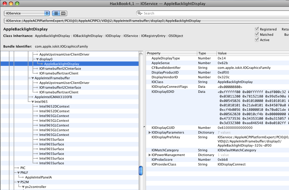

Slice Posted February 2, 2009 Share Posted February 2, 2009 This kext do nothing. Panel "Backlight" appers in registry but no more. The link is dead because the kext never works. I can propose use other solution for same purpose. 1. Make DSDT patch to insert the follow Device (PNLF) { Name (_HID, EisaId ("APP0002")) Name (_CID, "backlight") Name (_UID, 0x0A) Name (_STA, 0x0B) } Then replace IOGraphicsFamily to patched one. IOGraphicsFamily172.kext.zip Result Link to comment Share on other sites More sharing options...

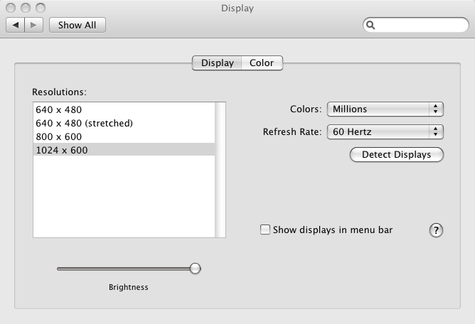

jinnggoff Posted February 3, 2009 Share Posted February 3, 2009 Hi Slice, I tried your suggest to Msi Wind Thanks for your suggest I found brigthness controll in display properties. And controll can move, However there is no effect to the display. Is there possible for brightnes controll can work? here the picture Link to comment Share on other sites More sharing options...

Aranius Posted February 7, 2009 Share Posted February 7, 2009 doing this showed me the brightnessthing in Monitor, and presisng my BrightnesscontrolKeys shows the faded thing on my Display, but it doesn't do anything, when i change the Brightness via Monitor it instantly flips back to the beginning and nothing happens... (Auto-Dimm from EnergieSaver doesn't do a thing either) Link to comment Share on other sites More sharing options...
