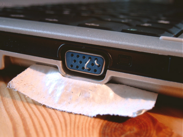

i've re-read your post. and realized that you it's a pre-installation problem. hehe.. i just have a thing for you..
attached is the picture of how it looks on mine. this is called the hair-pin trick for 915 chipsets.. hehehe.. just follow the look of the picture to short some pins like 1 and 6, then 2-12 or simply attached an external monitor for this.. :P

Thanks! Will try and post back here!

P.S.: Thanks for the paper clip trick! Used it and it worked!!!
