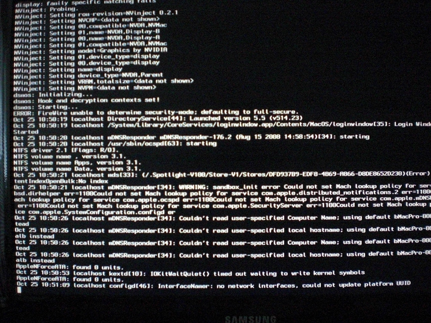

Hey there. I'm so close, I need a little guidance..
1. Your MOBO brand and model: This is hard, computer is a gateway, and the motherboard is an MSI with an NForce chipset, but it's not any specific model. it's pretty standard though, very similar to the P6MG series.
2. Your nForce Series 5 or 6 chipset: it's the nForce MCP73 series..
3. Your Intel CPU: Intel Core 2 Duo 2.6 ghz
4. Can't get any SS right now.
5. Your DVDRW(s): I have one SATA DVDRW and one PATA DVDRW, neither have solved my problem though.
6. Your hard drive(s): 1 500GB SATA drive, partitioned into a Vista partition, an XP partition, a media partition, and one I left for OSX.
8. Current OS's installed: Windows Vista, Windows XP.
9. Your graphics card(s): Geforce 2 MX 440, but there is also an onboard Geforce 7100, I am not using that though, it's disabled.
10. PCI/PCI-E cards fitted: Wifi card, SMC.
11. Onboard devices/functions: Realtek HD audio, SATA, not sure what else to put..
1. Your available OSx86 Install DVD(s): Retail and iDeneb 10.5.5
OK! Onto the issue..
I know what the problem is, I think. The only drive I have is a SATA drive, and the OSX installer won't see it. Is there some kind of SATA kext I need to load somehow..? When I used the SATA DVDRW to boot, I got the 'waiting for boot device' error. When I moved to a PATA DVD drive, It worked, but my SATA that I wanted to install onto didn't. I also tried cloning the image into a PATA HD and booted from it, same results as the PATA DVD drive.
This leads me to believe that there just aren't correct SATA drivers being loaded... How can I fix this on the nForce chipset?

The problems you have been having are surprising.........
Assuming you have double-checked your BIOS settings and they are OK......I would suggest a clean Kalyway 10.5.2 reinstall with no video, audio or network selections made in Customize menu, and then in fact removing all the following kexts.....
mount -uw / (press Enter after each command line entry in blue)
cd /System/Library/Extensions
rm -rf GeForce.kext
rm -rf Ge*.kext
rm -rf NV*.kext
rm Extensions.mkext
chown -R root:wheel Extensions (can also use 0:0 instead of root:wheel)
chmod -R go-w Extensions
exit
and boot successfully with basic VGA video mode and the System Profiler should show under Graphics/Displays, 1024x768 resolution 32-bit Color depth and 32MB VRAM with Software Driven CI and QE Not Supported, and against Kernel Extension Info: No kext loaded......

Hi nz_mitch:
I have read all posts here and your success story. I have exactly the same screen as you .Could you please help:
1.the detailed option in customermize part. I mean,which one in nForce chipset fix and, you did not select AppleSMBIOS?
2.I remember that , only when you remove all nv related kexts, you can boot. But you never mentioned it later ,how you solve the problem now? Sorry I use your picture to show my problem.
Really thanks

@pengyu
Verdant might what to clarify this but here's three things I'd try:
1. Just try booting with the PATA DVD disconnected and see what happens
2. Delete all of the kexts (the Nvidia ones) I mentioned above. You can do this by booting with the boot DVD and using terminal, but probably the easiest way to do it is to reboot into Windows and download and install MacDrive. It has a 5 day trial or something so you'll be able to jump in and delete them through the Windows GUI. In my case, all of the kexts are located here: M:\System\Library\Extensions. The reason I didn't mention this in my final instructions was because the second time I installed I didn't use any nvidia drivers and it seemed to boot fine into safe mode where I installed them later as I need the brand new Macbook Pro drivers for my 9600GT.
3. For the installation I selected the first nForce chipset fix. I think the other one is called old, I did not select this one (so I picked the latest one you can tick; although I got the impression that if you didn't tick anything it would be default install a later nForce fix built into the patched DVD). I select Mac Pro or whatever it is for AppleSMBIOS. As far as I can tell, but I'm not 100% sure, all this does is define your computer as a Mac Pro when you're using it, so it's purely for cosmetic purposes and shouldn't change anything. Verdant I'm sure will be able to confirm/deny this suspicion. ;)
If none of that works can you post up as per Verdant's instructions, eg. your hardware specs, your installation attempts so far. I'm guessing at the moment you've got similar hardware to me...
You might also want to try disabling your NIC in the bios, although that didn't make a difference for me. Just jump into the bios and it's usually under Integrated Periphals > MAC Devices or something similar. Just switch from auto to disabled.

Hi Verdent:
Thank you very much. I have been spent over one week for the installation and I read here something really helpful . I am downloading Kalyway edition and will give it a try . before that I will try the iDeneb 10.5.5 again.Thanks again and I will update my progess by tomorrow.
@pengyu
3. For the installation I selected the first nForce chipset fix. I think the other one is called old, I did not select this one (so I picked the latest one you can tick; although I got the impression that if you didn't tick anything it would be default install a later nForce fix built into the patched DVD). I select Mac Pro or whatever it is for AppleSMBIOS. As far as I can tell, but I'm not 100% sure, all this does is define your computer as a Mac Pro when you're using it, so it's purely for cosmetic purposes and shouldn't change anything. Verdant I'm sure will be able to confirm/deny this suspicion. :D
Thanks :P
EDIT: Heh, Verdant - you're quick. Got in while I was typing! :P
EDIT2: No, not at all! If anything I'm impressed with how switched on you are. :)
Hi nz_mich:
Thanks a lot for your reply . I have been struggling on the installation for about 1 week.
Acturally I am using :E5200 cpu ,Biostar GF7100P-M7 Mobo(nforce630i), DDR2800 1Gx2 and PATA DVDROM, IDE 160G(Seagate) and a nv 9500GT 256M. I have no obvious problem during installation, but the same problem as you were when reboot after installation.
I have modified my BIOS per "Leopard on Series 7 NVIDIA nForce ". and tried remove my DVD driver after installation but still the same problem. now I am downloading Kalyway edition and will give it a try., but before that I will try your way with iDeneb because it is 10.5.5 , I am a little aftraid of upgrade
By the way ,do you have the download address of NVdarwin v1.2.3? I can not find that link.
Thanks again.
Hi Verdent:
Hi nz_mich:
Thanks again.
See post #1 in this thread for nForce Drivers package..... ;)
Well I have tried iDeneb (patched and unpatched), Kalaway, and Leo4all, and nothing I do makes any of the installers see my SATA hard drive. I have tried booting the installs from a PATA-DVD, USB HD, and a second IDE internal HD, and nothing works. I realize I could install the OS to the IDE drive, but it wouldn't read any of my SATA devices, and I don't want that. It's kind of useless to me to have an 'isolated' install..
Anyone have any more tips? I really want to get this working, I know the issue is SATA drivers, can someone help?
Try installing the OS X system to the IDE hard drive, update it to 10.5.5 using Mysticus C* updaters and nForce Drivers package.....then use CCC 3.1.2 to clone it to the SATA HDD.....then use OSx86Tools to install Netkas PC_EFI v8 bootloader..... :huh:
How is OSX going to read the SATA HDD after install if it can't read it before the install? Do some kind of drivers get installed during setup that would then allow for the full install to read the SATA drive? If that's the case, I wouldn't even need to clone, the point is I want to be able to read from the SATA drive in OSX..
@karafa
I'd wait for Verdant to confirm, but my SATA DVD would not work at all during the installation. Post install I removed the PATA DVD I used to install and reconnected the SATA DVD and it worked straight away. I can even press F12 to make it eject. *makes it eject* :huh:
@karafa
I'd wait for Verdant to confirm, but my SATA DVD would not work at all during the installation. Post install I removed the PATA DVD I used to install and reconnected the SATA DVD and it worked straight away. I can even press F12 to make it eject. *makes it eject* :)
@karafa
It is strange and I do not really understand why but SATA DVDRW "calls" to a SATA HDD (and even to a PATA (IDE) HDD on occasion) are problematic......whereas SATA HDD or PATA HDD "calls" to a SATA DVDRW are not....... :)
So an installed OS vs an installer won't be any different?
I really just want to find a way to get the installer to see the SATA HD..
You would have to patch the installer DVD bootloader "process" with e.g. MeDevils AppleNForceATA.kext, or slashack's nForceATA kext to see if they enable the installer DVD in the SATA or PATA DVDRW to see the SATA HDD.......it could be that your SATA vendor and device IDs are not listed in the nForceATA kext......
