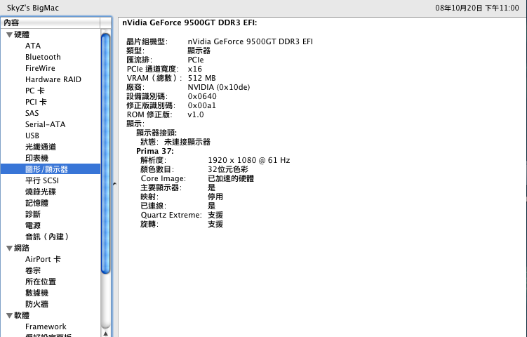

SkyZ Posted October 20, 2008 Share Posted October 20, 2008 hi there, today just got a 9500GT with native HDMI port, and it works like a charm~~~ Link to comment Share on other sites More sharing options...
