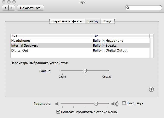

_caine Posted October 13, 2008 Share Posted October 13, 2008 This time kext loaded, device detected, but there's no sound at all. Sorry, my fault! After kext reinstalling default output device was set to headphones and thus i wasn't able to hear anything in my speakers:). After changing default output to internal speakers sound appears. But still there's no line input:(. I didn't tested mic input but at least as output this driver works fine! Thanks! Link to comment Share on other sites More sharing options...

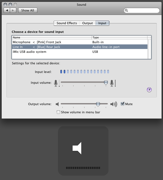

AlainTox714 Posted October 13, 2008 Author Share Posted October 13, 2008 Fully working v3 release for Bad Axe 2 STAC9274D Outputs : Headphones, Speakers, Digital Out* Inputs : Microphone, Line In Mute functionality working. * Digital Out not tested as i can't. Enjoy. Warning: DELETE the old HDAEnabler.kext and use the new one otherwise AppleHDA.kext v3 will not work. kext REMOVED This kexts work: sound output, if switch to headphones - ....silence. Microphone input still don`t work. But all the same thank you for what you helped us all. GLOXZ, Something i notice is that only Front Ouput & Input are not working. Did you check the wirring? Does these jack works with Linux or Windows? v3 release for you, as i use a different layout with some luck it could work. kext REMOVED Link to comment Share on other sites More sharing options...

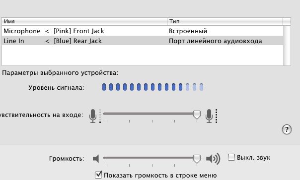

_caine Posted October 13, 2008 Share Posted October 13, 2008 v3 release for you, as i use a different layout with some luck it could work. Headphones and LineOut works fine. Both FrontMic and LineIn pins reacts on incoming signal with peakmeters but there's no incoming sound in speakers. Is this normal for OS X? I've just never used LineIn or MicIn before . Link to comment Share on other sites More sharing options...

tasc Posted October 13, 2008 Share Posted October 13, 2008 _caine, that's normal. You can test it out by firing up garage band and recording a real instrument track, should pick up the line/mic in. I believe there is also a toggle for 'monitor' so you can hear the mic immediately through speakers without recording. Now if I could just find a mic with a decent input level! Link to comment Share on other sites More sharing options...

AlainTox714 Posted October 14, 2008 Author Share Posted October 14, 2008 Works great, thanks Alain! Isn't there also a pink REAR microphone jack on this board? When i route Internal Microphone to rear Pink Jack, even if it show up in Sound pref and is selectable it doesn't work, no signal. Original Mac have a Microphone/Line Input at back which detects automaticly what is connected. So i have to choise between a Line Input or a Back Microphone which did not works. Headphones and LineOut works fine. Both FrontMic and LineIn pins reacts on incoming signal with peakmeters but there's no incoming sound in speakers. Is this normal for OS X? I've just never used LineIn or MicIn before . Glad to see STAC9271D on DP35DP mobo working. Link to comment Share on other sites More sharing options...

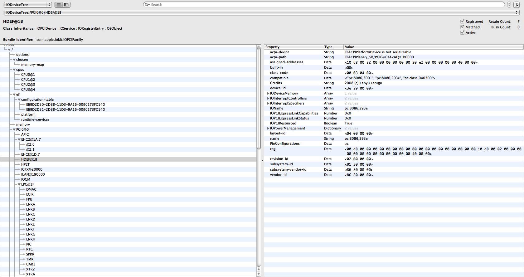

AlainTox714 Posted October 14, 2008 Author Share Posted October 14, 2008 i have stac9221d a2... 975xbx(badaxe1)already taruga's applehadpatcher was done but not working mic.. help me here my dump codec Here we are for test, please report. You have to set/check the right IOPCIPrimaryMatch 0x____8086 for your mobo in: AppleHDA.kext/Contents/PlugIns/AppleHDAController.kext/Contents/Info.plist kext REMOVED Link to comment Share on other sites More sharing options...

_caine Posted October 14, 2008 Share Posted October 14, 2008 btw, how do i get the IOPCIPrimaryMatch on my audio onboard intel dp35dp? -> For DP35DP IOPCIPrimaryMatch 0x293e8086 mobo. Link to comment Share on other sites More sharing options...
AlainTox714 Posted October 14, 2008 Author Share Posted October 14, 2008 can't wait to get home & try this. presently using ALCinject + patched AppleHDA but line-in/mic not working. would love to see your work Alain complete my onboard audio. will post feedback later. tnx a lot for providing support to audio-for-osx86! + + + + + btw, how do i get the IOPCIPrimaryMatch on my audio onboard intel dp35dp? thought i was sure. I already put it IOPCIPrimaryMatch 0x293e8086, just check. _caine member own the same mobo and it works for him. Link to comment Share on other sites More sharing options...
