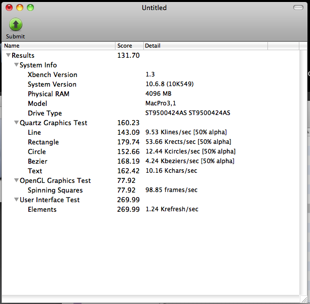

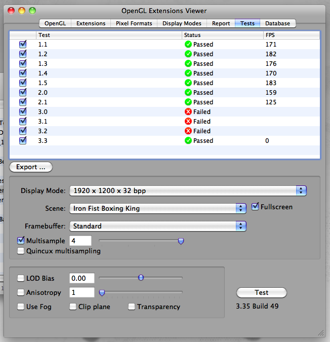

comankha Posted January 27, 2012 Share Posted January 27, 2012 some nvidia quadro benchmarks: Link to comment Share on other sites More sharing options...

comankha Posted January 29, 2012 Share Posted January 29, 2012 it is definitely DSDT issue. when booted without dsdt file (and of course with cpus=1 for successful boot) all ports are working. transfer is still crippled but this is something to figure out yet, Apple monitor bundle from 6.7 didn't help much. netroms' dsdt file doesn't fork for me at all, i use modified one found on some elitebook pages, so nw9440 may be a bit different. as editing dsdt's for me is like walking in the dark I'll wait till someone finds satisfactory solution. Anyway, I consider hard disk speeds cormal having some experiences with real macs and other hackintoshes, so no prob, it boots fast, works fine with big files etc. I'd be glad to see graphic benchmarks from ati x1600, nvidia quadro 1500 beats it in 3dmark and other tests by 300-350%. I use my hakmacs for video related work so working vga/dvi (via dock) comes as a blessing. Link to comment Share on other sites More sharing options...

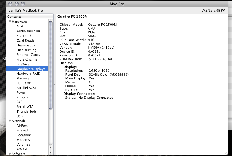

isidoro Posted June 29, 2012 Share Posted June 29, 2012 Actually I just checked and my Quadro is revision A2 with vbios version 5.71.22.43.A8. Would you be able to help me out and check what your card's revision number and vbios version it has? On Windows you can use a free app called GPU-Z and on Mac OS X I think an App called Zeus is similar, or OpenGL Extensions viewer, all free. If you can find those numbers for me, and they are different from mine, it could explain why my card won't work. Thanks in advance. Link to comment Share on other sites More sharing options...
comankha Posted July 2, 2012 Share Posted July 2, 2012 checked - my quadro fx has the same revision. also right now i'm using nx9420 mobo (nw9440 poer circuit died some time ago) and osx behaves in the same way (eg. sometimes needs help with cpus=1). my os version is leo snow 10.6.8. Link to comment Share on other sites More sharing options...
