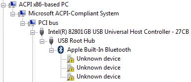

Anyone using the Microsoft stack unable to get the children of the Apple Built-In Bluetooth device working? Specifically:
BTH\MS_RFCOMM\6&2ccd287a&0&0
BTH\MS_BTHBRB\6&2ccd287a&0&1
BTH\MS_BTHPAN\6&2ccd287a&0&2
Updating the bth.inf file would not help me load drivers for these. Although the Microsoft Bluetooth control panel will identify and add Bluetooth devices, I suspect that the lack of drivers\profiles is keeping them from working.
Anyone else see in device manager these listings by connection... (see attached)
Or these by type... (see attached)
Update: If you see these then your install has forgotten where the drivers are supposed to be. Have your device manager update drivers point to c:\windows\system32 and it will find them all there. Vista gets confused after you look in new places for drivers and it seems to forget the default locations for them.
