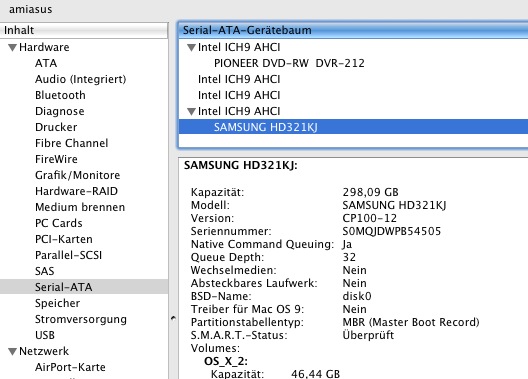

mitch_de Posted August 28, 2008 Share Posted August 28, 2008 I have now my new GA-EP35-DS3 Board. (switched from MSI P965 - also no problems!) Q: All seams to work . I only installed the 889A for Audio: WORKS ! Is my SATA shown at screenshoot fastest ? I heraed about some "coulored HD Icons", i dont have that. Also: Has anyone DL Link / can share EFI-boot-cd for the OSX DVD boot with GA-EP35-DS3 ? Link to comment Share on other sites More sharing options...

~pcwiz Posted September 4, 2008 Author Share Posted September 4, 2008 OK sorry guys for the late reply, I'm really busy and don't have a lot of time anymore. Let's start. Lolrus, Actually the JMicron patch is the one that CREATES the 4GB+ issues, not solves them. If you have IDE devices and 4GB or more of RAM its not recommended. mitch_de, The orange drive issue is only when SATA is in AHCI mode. Technically its not a mistake, since SATA AHCI drives are "hot pluggable" (meaning you can take them out and put them in without rebooting) they are sorta colored as external devices. Not a big issue, but most of the recent OSx86 releases I've seen don't have this issue so no need to worry. tombo, Yeah, the drivers in this package are older ones (skippyretards install pkg + HDAEnabler) so I might grab the newest ones off of Taruga's site or patch my own, and then package it. We'll see phreakazoidz, Its probably the Restart Fix that messed it up since it replaces AppleACPIPlatform.kext. Can you boot into the machine or access single user mode? If you can, it can be fixed since the app auto backs up your original kexts before modifying. And...thanks to everyone that said thanks Link to comment Share on other sites More sharing options...
