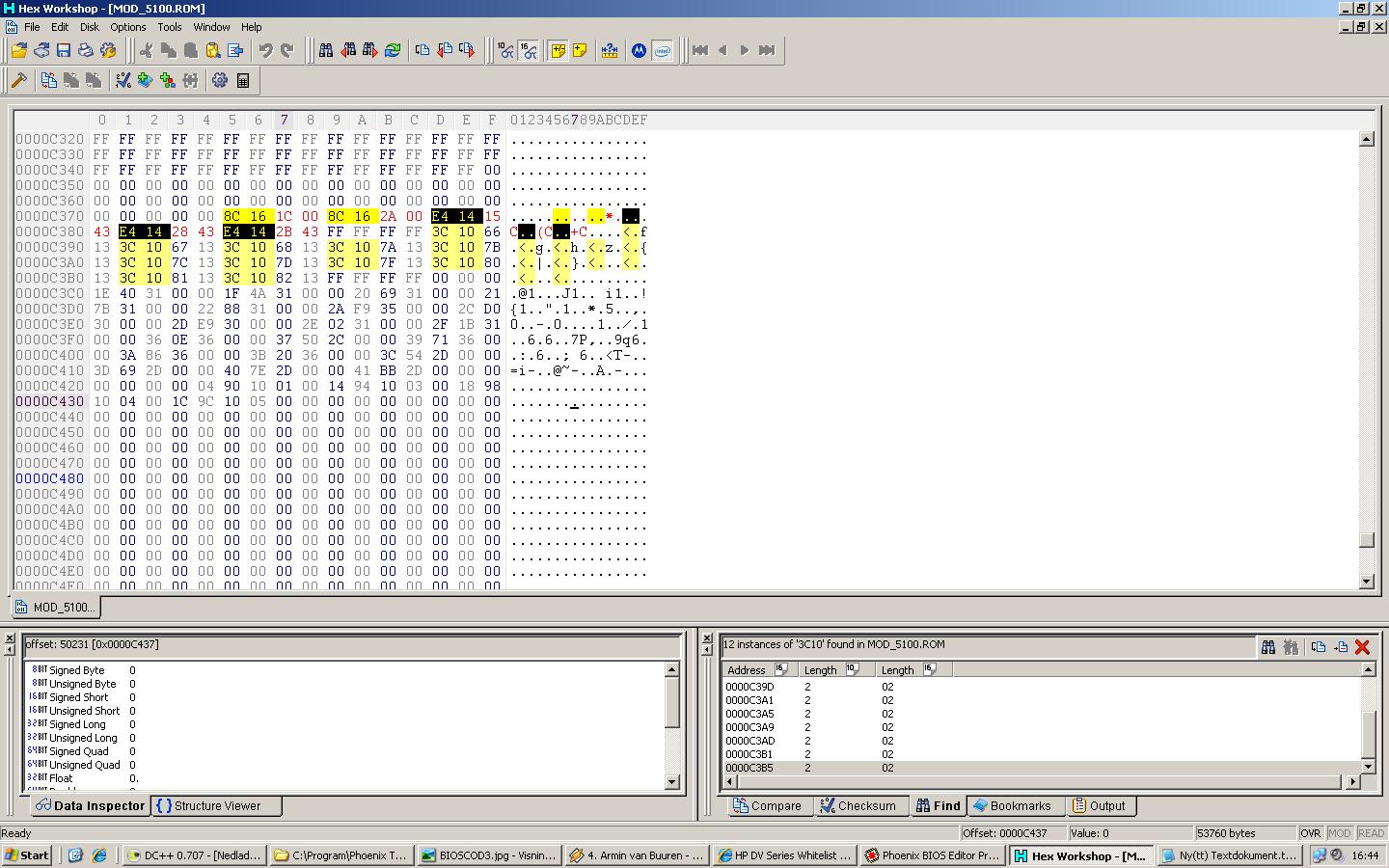

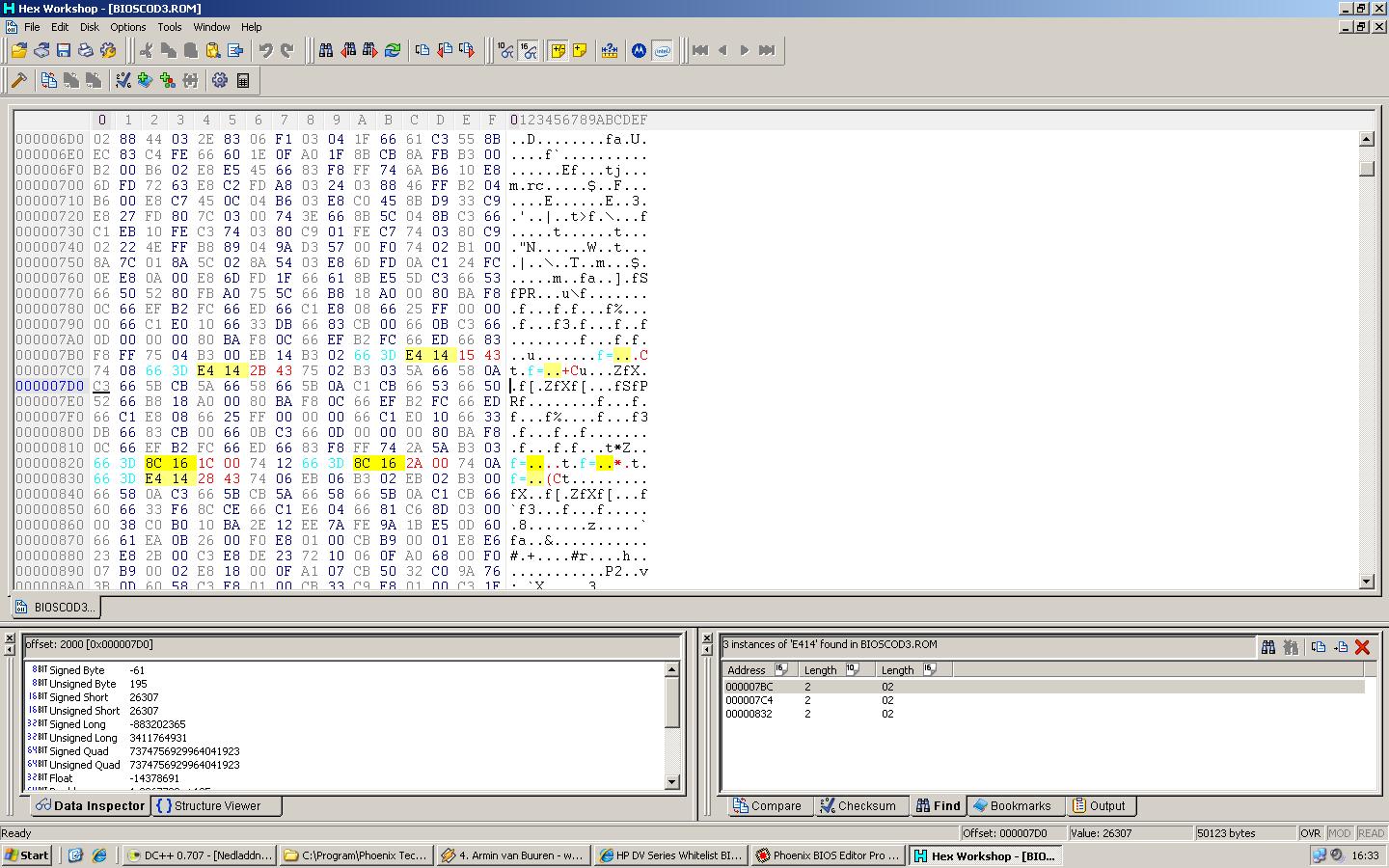

Mukole is going to confirm the RLS module 3 error soon. With the F.58A(dv9000) and the F.29(dv6000). In BIOSCOD4.ROM, is a complied list of ven ids, device ids etc, that is the whitelist of accepted cards. In the pictures I have post previously on this thread, you can see that the F9EB01F8 code is just a couple of characters away from the whitelist. By changing that F9 to F8 will stop the whitelist. But not all HP BIOS are that easy. I am currently working on the F.24A bios right now and HP has moved the whitelist to BIOSCOD1.ROM and there is no F9EB01F8 code right before the whitelist, but there is a whitelist of vens. What I believe HP has done is moved the F9EB01F8 code into BIOSCOD0.ROM and applied a linking code to the whitelist in BIOSCOD1.ROM. The linking code is 6661 which is right before the whitelist in BIOSCOD1 and allso right after the a F9EB01F8 code in BIOSCOD1. I have a tester that is willing to try this F.24A. I will report back on here with results about the F.24A. If the results come back about the RLS error and it is NOT causing the bad flash, I will try and work on the F.2B since it is a popular BIOS. Thank you for the help and support everybody.

anyways i posted this one but it seems u didn't see it . i found one F9EB01F8 inside MOD_5100.ROM and i changed the F9 to F8 . try it if you want . cus this is different . there is no whitelist inside all the BIOSCODE.ROMs . the whitelist is clearly inside MOD_5100.ROM cus you can clearly see all the DEV AND VEN AND SUBSYS . full ids of all wireless cards. so i believe this is it .
try it and tell me if you pass whitelist. if it didn't . there is another thing we can do is to change F9 to F8 inside BIOSCOD3.ROM the one before the wireless card's VENs . and change F9 to F8 inside MOD_5100.ROM and build . because probably these two are linked. which i don't think so . anyways try and i hope u'll be successful.

wow , well i don't know what else i should change . in this last one i changed . the F9 to F8 inside BIOSCOD3.ROM right before the wireless cards idea. and i changed the F9 to F8 inside MOD_5100.ROM . i found that these 2 kinda relate to eachothers. but now i'm suprized why it doesn't work . i don't know what else to change .
