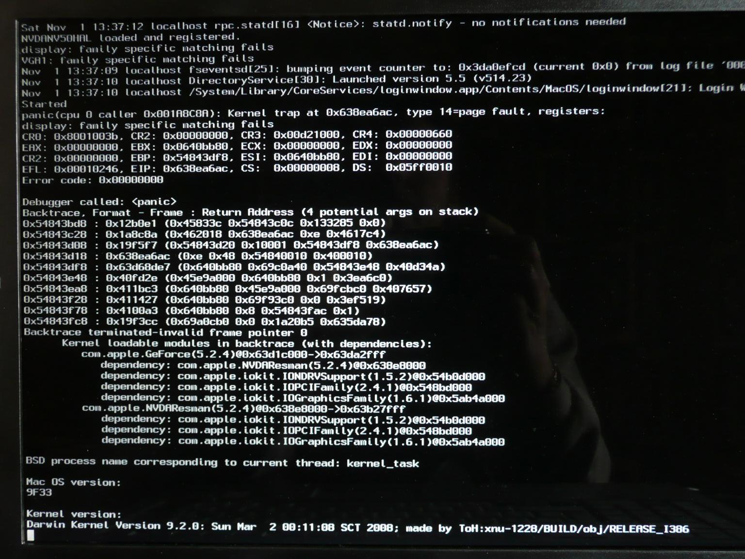

I do seem to get some of those errors, they say error loading AppleHDA.kext, IOHDFamilyController.kext, etc...
Specifically, what errors if any are you getting similar to those in this extract from my blog, and did you follow the procedure outlined below before running each graphics driver installer you have tried.....
Kernel loadable modules in backtrace (with dependencies):
com.apple.GeForce(5.2.4)@0x7fab3000->0x7fb39fff
dependency: com.apple.NVDAResman(5.2.4)@0x7f873000
dependency: com.apple.iokit.IONDRVSupport(1.5)@0x7f865000
dependency: com.apple.iokit.IOPCIFamily(2.4.1)@0x77a36000
dependency: com.apple.iokit.IOGraphicsFamily(1.5.1)@0x7f849000
com.apple.NVDAResman(5.2.4)@0x7f873000->0x7fab2fff
BSD process name corresponding to current thread: kernel_task
Mac OS version:
9C7010
Kernel version:
Darwin Kernel Version 9.2.0: Tue Feb 5 16:13:22 PST 2008; root:xnu-1228.3.13~1/RELEASE_I386
This kernel panic points to a GeForce Driver(s) error.... at least for my GeForce 8600GT 256MB graphics card.....
B)
even though I had picked no nVidia drivers! Thus the base OS X system drivers could not drive my GeForce 8600GT....
B)
If you have a similar kernel panic do not expect to see the same hexadecimal numbers as in the example above.....
For a solution, see for example :
QUOTE
com.apple.GeForce; com.apple.NVDAResman Kernel Panic Issue
Issue: System stops on Kernel Panic during boot.
Solution:This is caused by the GeForce Kexts that are installed by default. The issue is resolved by removing the GeForce kexts at boot, and it can be done as follows:
boot with -s
mount -uw /
rm -rf /System/Library/Extensions/GeForce.kext
rm -rf /System/Library/Extensions/Ge*.kext
rm -rf /System/Library/Extensions/NV*kext
exit
ENDQUOTE
