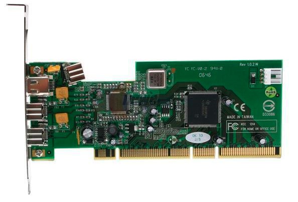

Kyle Gilman Posted June 2, 2008 Share Posted June 2, 2008 I'm running Kalyway 10.5.2 (vanilla kernel) on an Asus P5K-E motherboard with a Q6600 processor. I have a Koutech 3+1 Port FireWire/1394b & 1394a PCI Host Controller Model 1314 for Firewire I/O. I'm editing HD video in ProRes HQ, which requires about 23 MB/s. Unfortunately, when I have external drives plugged in to the Firewire 800 or 400 ports on the PCI card, I only get about 20 MB/s when reading from the disk, which causes dropped frames. The write speed is about 30 MB/s. When the drive is plugged in using an eSATA port I get around 40 MB/s for read and write. I also get around 40 MB/s when the drive is plugged in to the same Firewire 800 port in Windows XP on the same computer, and the Firewire 800 port on my MacBook Pro which is also running 10.5.2. So I only get this problem when plugged in via firewire in OS X on the hackintosh. I tried a different PCI firewire (400 only) card that also gave me 20 MB/s in OS X. I'm doing these tests without any other Firewire devices attached. I've been searching the forums a lot and I don't see anyone mentioning speed problems with their firewire drives. I know the simple answer to my problem is to just use eSATA, which is fine for now on this project, but not all external drives have eSATA, and I work with a LOT of different external drives. I'd like to be able to count on my firewire connections. Does anyone have any ideas? Link to comment Share on other sites More sharing options...
