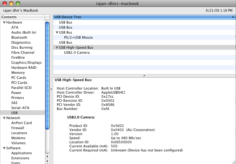

anyway my cam (based on ali m5602 chip) does not work with any solution provided above
so any ideas would be appreciated
and this is how it shows up in system profiler. i got no idea why it doesnt work. (tried camtwist and every software out there). cant even see myself in the cam for taking a photo for my account. any idea whats the prob??

For ref mine is device ID 04f2 PID B013
VDC may still be the issue but apple has changed it a lot and now photobooth will not even run if you delete it like before in OSX 10.5. Like many have said before its a res detection issue or fps issue.
I think the key to getting cams working is UVC and the VDC.plugin. We need to pull the VDC.plugin apart and look at all the parts of it. I have already ripped out parts under resources and it has not helped. I think its something in that plugin causing the cams to not work when they should.
Ill continue working on this but would apprciate any assistance.
  • 2 weeks later...
Well i have a sonix built in cam with mic.
The funny part is that, it doesnt seem to work on xp, it doesn seem to work on win7 and! same thing on 10.5.8/7. The notebook orginally came with a home vista, had the cam working. Today i disassembled the notebook just to check the chips codes. I found my cam is a sonix SN9C260AJ which is nowhere to be found i even got a picture of it, the guys on the site dont have it listed its so so funny :rolleyes: i really hate this third companies. Also the funniest is. My lan which didnt worked on osx cause it was a sis191, turned to be a RTL8201CL LOL. So im gonna try some things here and there and checkback if somebody else owns a PACKARD BELL notebook, it would be nice to hear from you about some kexts.
