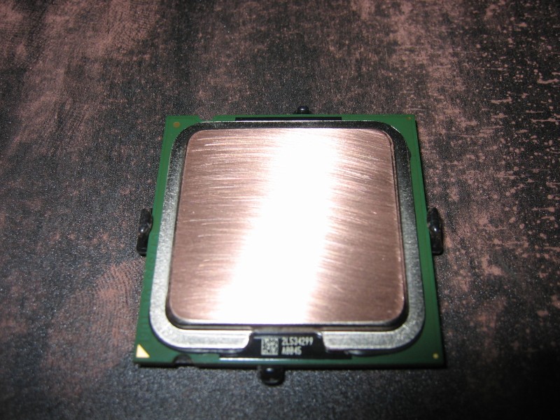

Hey, i was just wondering how many of you have lapped your CPU.
Here is a pic of what it looks like
Click to view attachment This has helped my q6600 (pre g0 steppings) at 3gz go from 75 full load to about 62 celcius. I am also using a thermalright 120 extreme HS with a 120mm Fan.
Here is what you do. Take your CPU out and protect the back of it(i used the original casing that it came in)
Find a very flat surface (i used a big piece of glass) and tape atleast 400-600 grit sand paper. You can move up the grit.. but to start out at 2000 would take to long.
These CPUS are very concave, you can see it if you put it on an angle.
To sand it, you want to dab a little amount of water on the sandpaper to keep any static shocks away. Sand until you have what looks like a flat surface. Make sure your moving the CPU on the sand paper, not the sand paper on the cpu. also make sure everything is extremely flat. Dont worry about a mirror finish, you just want to make sure that you cpu is not concave.
Ive done this with a q6600 and e6600 both with great results. You can also do this to the Heat sink fan your using... but depending on the shape of it, this could be more difficult.

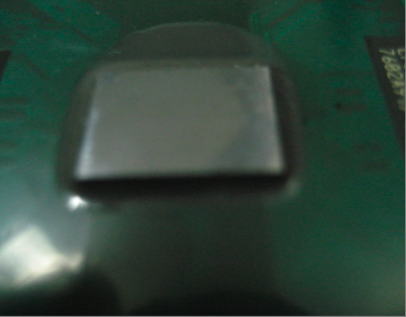

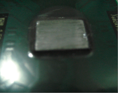

My MacBook Pro was running really hot, practically scalding (I thought the 45nm was supposed to be cooler) But aparently not! I read this thread on lapping the CPU and I figured it's worth a shot. Problem is I can't get it to boot now! It won't even turn on. I followd al the steps, right down to wetting the sandpaper to prevent static. It was pretty polished before I proceeded, I was thinking perhapse if the surface was a little more coarse then it would have a larger surface area. Any ideas on why it won't turn on? I didn't think lapping it would ruin it!
you dont lap a laptop cpu!
you are basically polishing the core itself, not a good idea.
you most likely have to shell out some $$ to get yourself a new cpu, sad to say but......ah screw it HAHA!
I really hope you're joking. They are all talking about lapping the IHS, the metal covering found on most modern cpus that you can buy as components (like a C2D e6750 etc. etc.) The pictures you're showing are of the actual core. If you sanded that... you're SOL.

Okay, Okay, I'm just messing with you! That was an old Core Solo I screwed with just for kicks and giggles... But I do say, I wouldn't put it past some people!

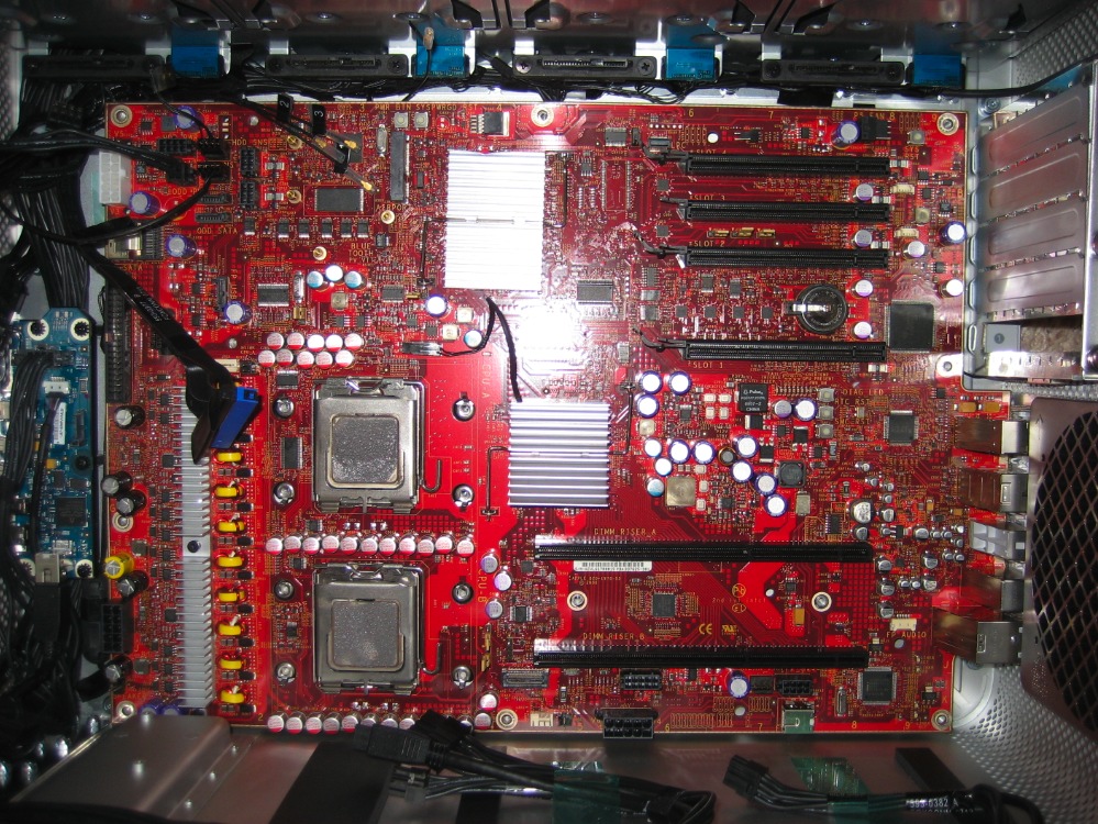

Right now I'm hoping to find anyone with some info on a Mac Pro Logic Board I got... It appears to be a prototype and it has jumpers on it that I have no idea what they do (Other than make the system say there is 1 cpu with 7 cores when I have 2 quad core cpus in it)... so if anyone has some idea on any info about the board, I'd love to hear it!

could be that since its a developer bored it combines both cpu as one, just a wild guess not sure, will look into this

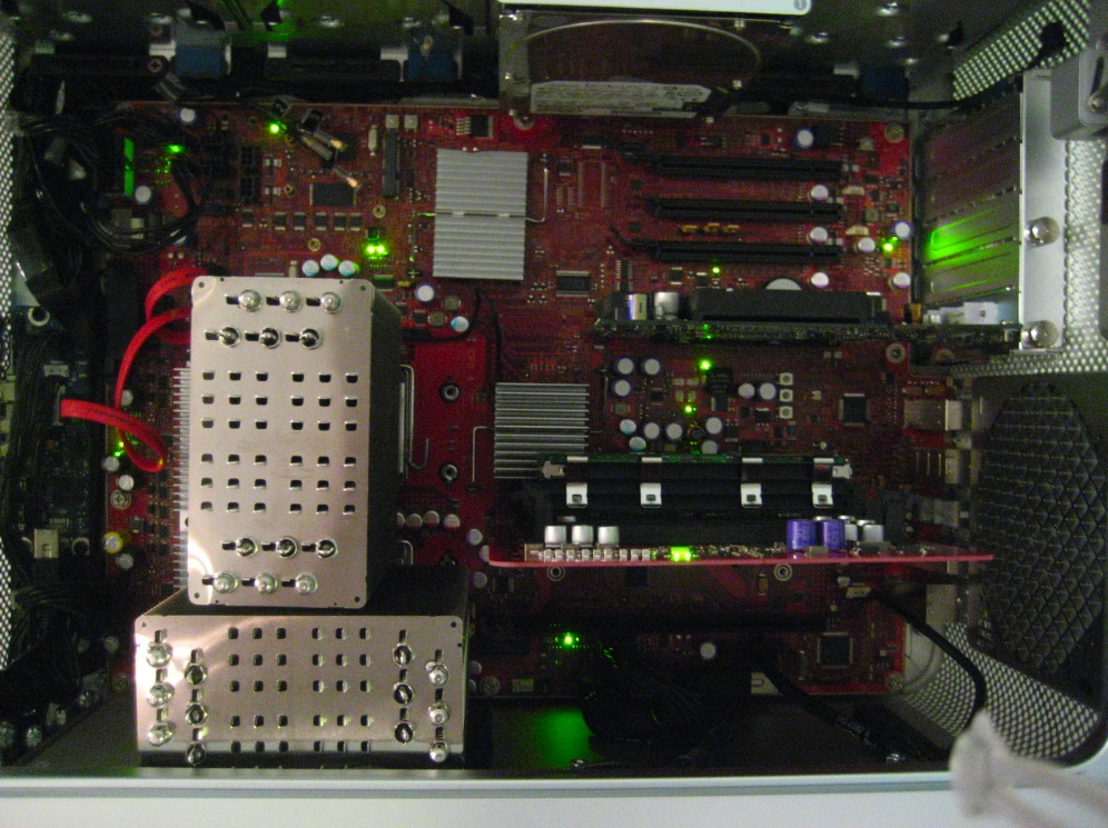

returning to this thread, I have a lapped E6750 under the hood of my workstation now...
made me chuckle seeing the moron that lapped the CPU die...
i did see a decrease in temperature, but now i'm running such specialized cooling components, it's hard to say what's making the bigger impact, the Innovation Cooling 7 karat Diamond based TIM, or the Scythe Ninja, with three 120mm fans in close proximity.
