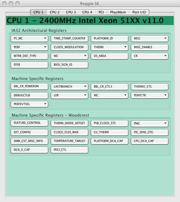

I've installed CHUD but we didn't seem to get the systems preference panel option. I had a look around in the CHUD folder and found a proggy called Reggie SE which looks to ID the CPU. It looks like it has recognised it as expected. I've attached a screen grab of Reggie SE showing the first core, the other 3 all contain the same data. Have a look and see if anything looks wrong if you could.

yeah it seems to recognize the cpu fine. please check as well with cpu-x if there is anything abnormal.

The CPU was a Q6600 after all, it was Reggie Se that was reporting it as a Xeon (it's not my system, it's a friends).
