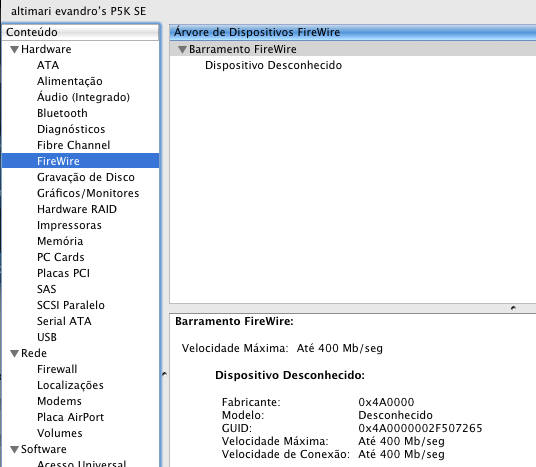

Hello blza staff? my rackintosh this perfect, not the firewire card
PCI, it connected to the system, so that does not work, when a plug
firewire device it shows, ex? (FireWire Bus:
Maximum Speed: Up to 400 Mb / sec,) while I read, someone has to
i used
Aipc 10.5.7
Asus pk5-se
Gforce n7200 gs
Core 2 duo 7200
Thanks !!
