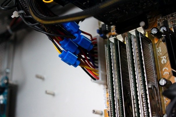

Epoxied bolts w/ steel/plastic flange nuts so i could make micro adjustments to the board height if necessary
(as the bottom pegs were right on the case lip this was necessary to keep the board perfectly level):
Click to view attachment
PS: No need for JB weld steel/epoxy [although it would look better] just avoid any fast set or marine epoxies and you'll be able to lift the entire case from any bolt;)

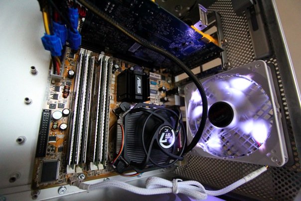

Dremelled the usual places for mobo and power supply:

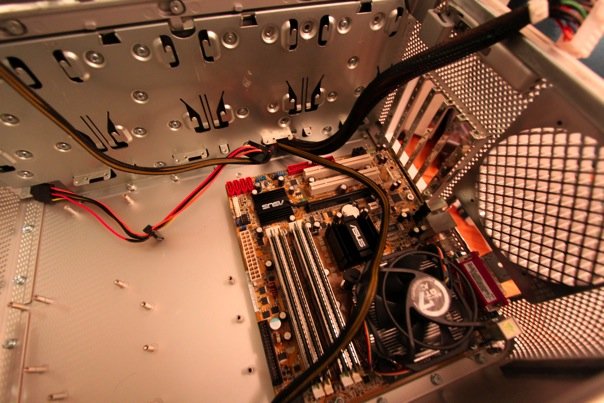

Reinforced the power supply w/ two internal screws (into existing taps)
This is the most "natural" airflow for the P/S (vs. a P/S with vertical air)
Also dremelled a small opening behind the 4th HD bay for the mobo/CPU/GPU and SATA power cords
This way I'm not pulling a crap load of cables through the bridge and to the front of the case and down

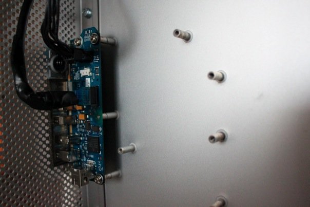

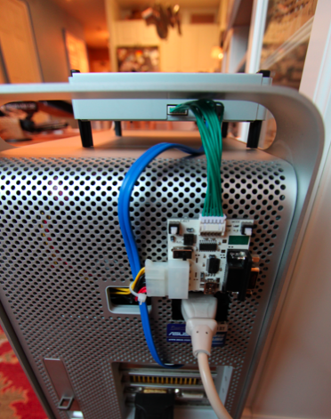

roughing the USB and Power leads (Firewire used a regular fw800 cable)
Tapped new guides for a rear chassis fan (blows out)
Testing the cabling and airflow (decided to disable rear fan led)

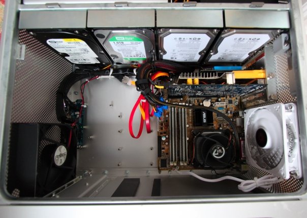

Connecting everything and cleaning it up w/ zip ties, cable covers, case clips
Epoxied another chassis fan to a strip of aluminum then epoxied that to the front/base, added plastic sheeting to ensure cold air is drawn 100% externally

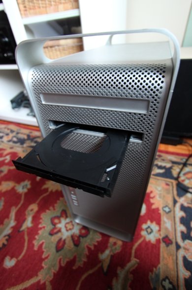

Used a Pioneer 217DBK (should perhaps have used a white 217D? whatever, ejects flawlessly once the pioneer's plastic tray/cover removed)
