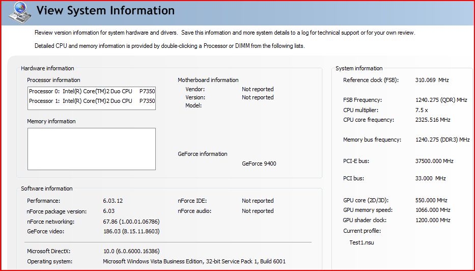

I have also overclocked my 2009 Mini 2.0GHz 4GB Ram 500GB 7200RPM HD. The results are in the image attached. This is my first overclocking job and I used the free nVidia Control Panel download to achieve the results. My "Windows Experience Index" went from 5.0 to 5.3.
Click to view attachment
