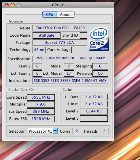

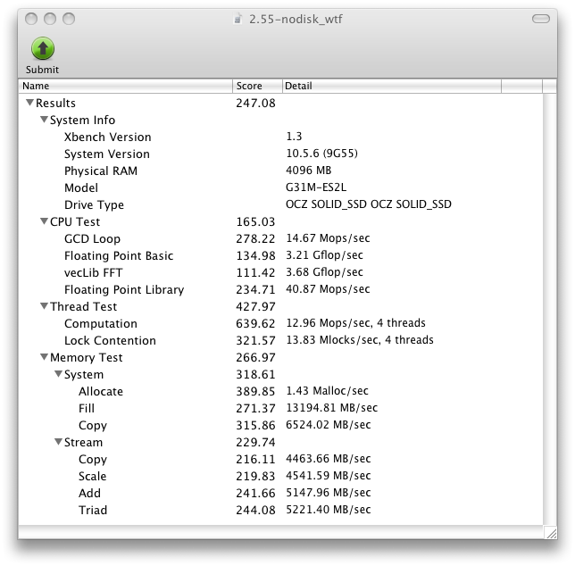

I did notice this little oddity, with the BIOS configured for 3.5Ghz I manage to get an xbench on cpu test ~240 and CPU-X shows it as 3.5Ghz
However I bumped it from 389 to 395 FSB in the bios which put me at 3.55Ghz... good news is OSX booted, bad news is CPU-X read it as 2.33Ghz (x6 multiplier instead of x9) and now xbench cpu tests gave me ~160.. WTF!? MSR Tools showed it as 3.56Ghz.. I am starting to think OSX has a problem w/me overclocking.

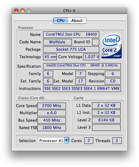

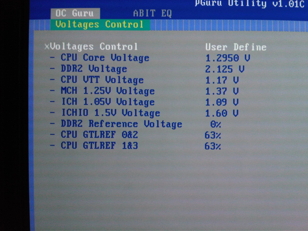

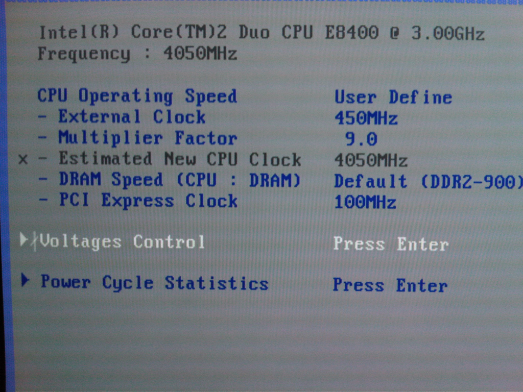

Took a couple of quick pictures of my settings, perhaps they will help you out. I know the screens aren't the same as you have a different motherboard, but you can see the voltages and such I am using. I've been running this setup for about a year now and haven't had any stability issues as of yet.
I've also included screenshots of CPU-X showing my CPU going from idle at 2700mhz to 4050 under load. There's a middle step in there of 3150, but I don't see it too often and it quickly switches to a higher or lower state.

Thanks for the screenshots, Ive set it up identical to that.. even with higher voltages.. I dont have any chipset voltage control though, perhaps thats holding me back
