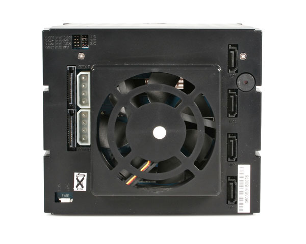

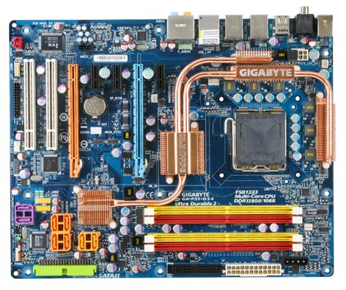

I have same Hot-Plug, Hot-Swap issue with ICH9R on P35-DS4.
I am using 4 Drive 3.5in Hot Swap SATA Mobile Rack Backplane Product ID: SATABAY4BK (Front & Back pic attached)
P35-DS4 (pic attached)
Disk BACKPLANE is connected to ICH9R orange SATA ports on the mainboard and powered on.
All four disks, if switch ON, get detected at boot up, fine.
Issues Present.
(i) No new SATA Disks get detected Automatically at being inserted while the system is already on, like you get Firewire and USB disks recognised at insertion.
(ii) Disks still shows in Disk Utility (greyed out though) after having been ejected.
(iii) After having been ejected and then re-inserted Disks can be remounted manually using Disk Utility in the 'same DISK, same Drive BAY' basis
(iv) The Icons for these disks are not orange (for removable disks), its same as the fixed disks.
