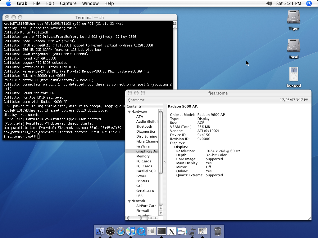

Largo, you're the man, thanks to you now I have, my ATI 9600 PRO AGP (ID: 0x4150) working at 1680x1050, 60hz Full QE, CI. thumbsup_anim.gif
image 10.4.8 Jas.Intel.AMD.SS2.SS3.

Hi latexgurl, I still havn't got it working correctly. I have tried putting in the correct EDID (which can be retrieved using a program called pheonix edid editor on windows) values for my monitor into Callisto.kext/Contents/Info.plist using Plist Editor Pro, but unfortunately it doesn't seem to be making a difference. No matter which resolution I try, my monitor loses connection. The only way I can boot now is in safe mode (-x). Going to try adding the Graphics Mode to my com.apple.Boot.plist to try and force the correct mode.
Output of Callisto at startup:
CallistoHAL Initialized!
Callisto: omni's ATI Driver&FrameBuffer, build 003 (fixed), 27-May-2006
Callisto: Model Radeon 9600 AP (rv370)
Callisto: MMIO range@0x18 (ffcf0000) mapped to kernel virtual address 0x2b66d000
Callisto: 256 MB DDR SGRAM found on 128 bit wide bus
Callisto: VRAM range@0x10 (c0000000:10000000)
Callisto: Found ROM @0xc0000
Callisto: Legacy ATI BIOS detected
Callisto: Retreived PLL infos from BIOS
Callisto: Reference=27.00 MHz (RefDiv=12) Memory=398.00 Mhz, System=200.00 MHz
Callisto: PLL min 20000 max 40000
Callisto: Connection on port 1 not detected, but there is connection on port 2 (swapping 2->1)
Callisto: Found Monitor: CRT
Callisto: Monitor EDID retrieved
Callisto: done with Radeon 9600 AP
If anyone has any ideas to get this working please let me know, this is the closest its ever been to working. smile.gif
EDIT: The last line of the command 'dmesg' says: display: Not usable
EDIT2: After deleting the saved screen resolution settings and removing I can boot the machine normally but with a screen resolution of 1024x768. If I try adding "Graphics Mode" in com.apple.Boot.plist I get a small screen in the top left corner and the mouse is barely visible. Everything is working other than that, QI, CI and opengl all working fine (with mouse artifacts).
See screenshot -->
This post has been edited by gambl0r: Mar 17 2007, 04:30 AM
