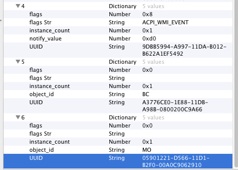

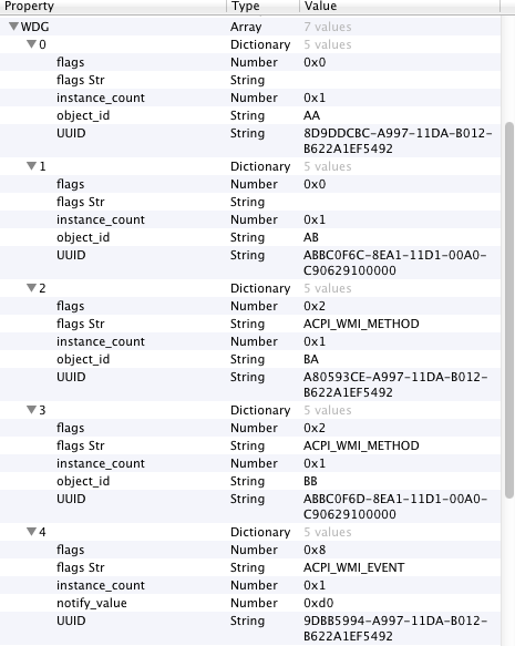

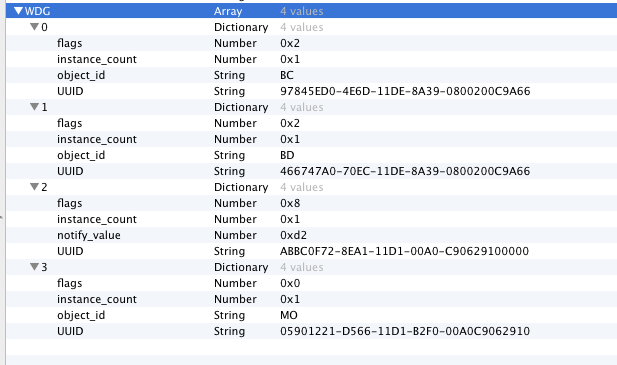

Can you post this kind of table:
You can take EeePCWMIController as an implementation template and take a look at the linux file dell-wmi.c I've put in reference to find the GUID, methods ID and etc.
As far as I can see in a XPS 1340 DSDT I've downloaded, I shall be possible.
Good luck
I'm sorry, I'm not sure when I can find that table
I sent PM actually before found this post.
ok, it loads normal, but I have no clue how I can fix it for my keyboard (that I wrote in PM).
Now backlight works using Fn+F5 down and Fn+F12 up. But in keyboard it is Fn+arrow up/down. Backlight changes when I press Fn+arrows but it doesn't have a picture in the screen.
http://www.amazon.com/Studio-Keyboard-Back...C/dp/B003FS14Q8
I have also Fn+F1 as sleep button that doesn't work at all now and Fn+F3 button that should change in windows battery mode (save or performance, it doesn't matter to launch Fn+F3).
I found also that there display switching button in the dell-wmi.c, but I have no clue how I can launch it for myself (my button it after F12 in keyboard).
Thank you for help.
Kernel.log now:
Sep 18 17:21:10 localhost kernel[0]: IOWMIController: WMI driver version 1.0 Device name: AMW0
Sep 18 17:21:10 localhost kernel[0]: NVWMIController: WMI driver version 1.0 Device name: WMI0
Sep 18 17:21:10 localhost kernel[0]: IOWMIController: WMI driver version 1.0 Device name: WMI1

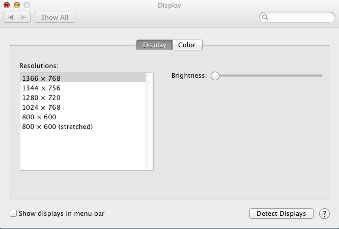

No slider in the preference pane unless i missed something?
DSDT.dsl attached.
dsdtmod.zip
I think AppleBacklightDisplay is not loading.
Verify with IORegistryExplorer or open Terminal and type:
ioreg -w0 -rtbSk AppleDisplayType
Verify on which display number your internal display is on.
if not display0 but display1, change @0, by @1, in properties injection
My display is definitely 0. AppleBacklightDisplay isn't loading as you said.
