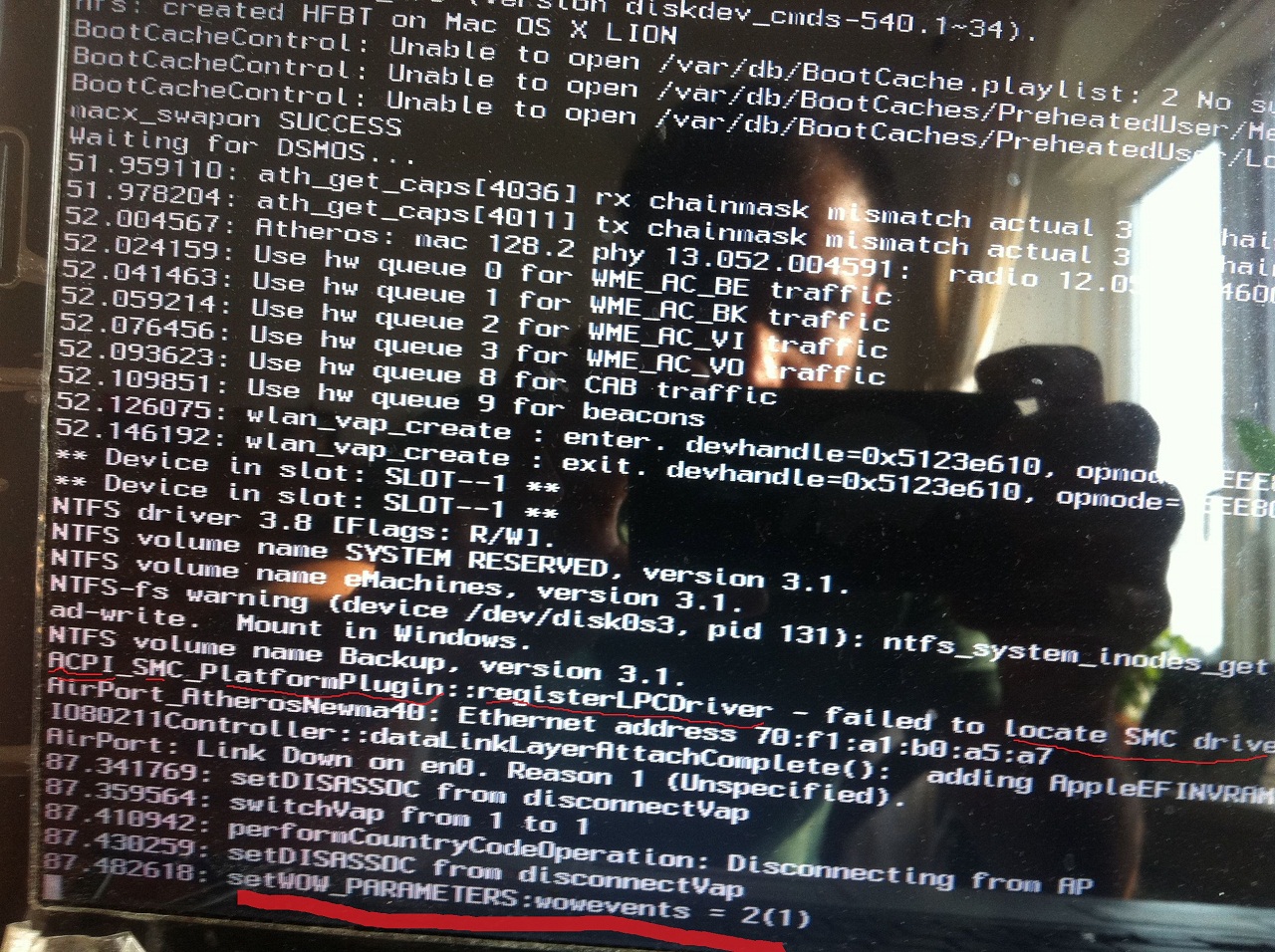

rakusson Posted August 25, 2011 Share Posted August 25, 2011 hi, I successfully installed Lion. I rebooted to Chameleon 2.0 rc5 and selected the installed drive (lion installed) to boot. It started to boot and got stuck on 87.482618:setWOW_PARAMETERS: wowevents = 2(1) After that I tried to reboot with PCIRootUID=1 -v then I was stuck on white screen with mouse cursor. again, I tried to boot with PCIRootUID=1 GraphicsEnabler = no -v This time, I was stuck on ACPI_SMC_Platformplugin:registerLPCD Driver - failed to located smc driver. I've attached a pic of error. Solved I edited system/CoreService/Setup Assistant.app/Contents/Info.plist removed these two lines <string>DeviceSection</string> <string>KeyboardTypeSection</string> from there and yes, didn't need any extra keyboard. now my trackpad, keyboard as well as external usb mouse all working including wifi. but Lan is not working as well as Graphics card. i'm getting 1024 * 768 resolution. Will install [url="http://www.insanelymac.com/forum/topic/279450-why-insanelymac-does-not-support-tonymacx86/"]#####[/url] now. let see. Link to comment Share on other sites More sharing options...
rakusson Posted August 25, 2011 Author Share Posted August 25, 2011 hi,I successfully installed Lion. I rebooted to Chameleon 2.0 rc5 and selected the installed drive (lion installed) to boot. It started to boot and got stuck on 87.482618:setWOW_PARAMETERS: wowevents = 2(1) After that I tried to reboot with PCIRootUID=1 -v then I was stuck on white screen with mouse cursor. again, I tried to boot with PCIRootUID=1 GraphicsEnabler = no -v This time, I was stuck on ACPI_SMC_Platformplugin:registerLPCD Driver - failed to located smc driver. I've attached a pic of error. I copied MacBookPro8,1 / Sandy Bridge extra folder to my bootable chameleon and started again. I just boot on -v and suddenly I went to next step but again stuck there. actually, after SetWOW error, the boot didn't stuck but went to "connect your keyboard" screen!! This is irony that while installing, my keyboard was working perfectly that's why I bough usb mouse and now, keyboard aint working???? what should I do? I used voodoops2 controller kext during installation. I will try to to use apple native keyboard kext and try again. let see what happens. btw, if you have any idea, please do share. I dont wanna buy a keyboard now. Link to comment Share on other sites More sharing options...
aufa333 Posted August 26, 2011 Share Posted August 26, 2011 most of us get into the ps2 keyboard prob 'bitchy lion' ,use this *if u have a ps2 keyboard and got stuck at the searching for keyboard screen ,then restart and boot into ur SL. >open ur Lion diver and search for /System/Library/CoreServices/Setup\ Assistant.app/Contents/Info.plist >open it and delete these lines <string>DeviceSection</string> <string>KeyboardTypeSection</string> Link to comment Share on other sites More sharing options...
rakusson Posted August 26, 2011 Author Share Posted August 26, 2011 most of us get into the ps2 keyboard prob 'bitchy lion' ,use this *if u have a ps2 keyboard and got stuck at the searching for keyboard screen ,then restart and boot into ur SL. >open ur Lion diver and search for /System/Library/CoreServices/Setup\ Assistant.app/Contents/Info.plist >open it and delete these lines <string>DeviceSection</string> <string>KeyboardTypeSection</string> Thanks for reply, I will try and let u know. btw, I don't have SL. I've a win7 partition and only one Lion partition. I'll boot from Installer USB and will use Terminal to located that file. What if that file is not present in my Lion installed partition? coz, I could not find that file in my Lion installer USB drive. Link to comment Share on other sites More sharing options...
rakusson Posted August 27, 2011 Author Share Posted August 27, 2011 most of us get into the ps2 keyboard prob 'bitchy lion' ,use this *if u have a ps2 keyboard and got stuck at the searching for keyboard screen ,then restart and boot into ur SL. >open ur Lion diver and search for /System/Library/CoreServices/Setup\ Assistant.app/Contents/Info.plist >open it and delete these lines <string>DeviceSection</string> <string>KeyboardTypeSection</string> Thanks aura333 for your suggestion, this solved my problem! I booted in my Lion partition with -s -v -x flag and hit some keys when the boot was handed over to Lion boot. then I got into the terminal in a read-only mode. I did following to be able to modify Info.plist fsck -fy mount -uw / Thanks again for suggestion. actually, typing from Lion now. Wifi worked after a reboot. But ATI card aint working. Will install [url="http://www.insanelymac.com/forum/topic/279450-why-insanelymac-does-not-support-tonymacx86/"]#####[/url]. haven't checked sound yet. Link to comment Share on other sites More sharing options...
