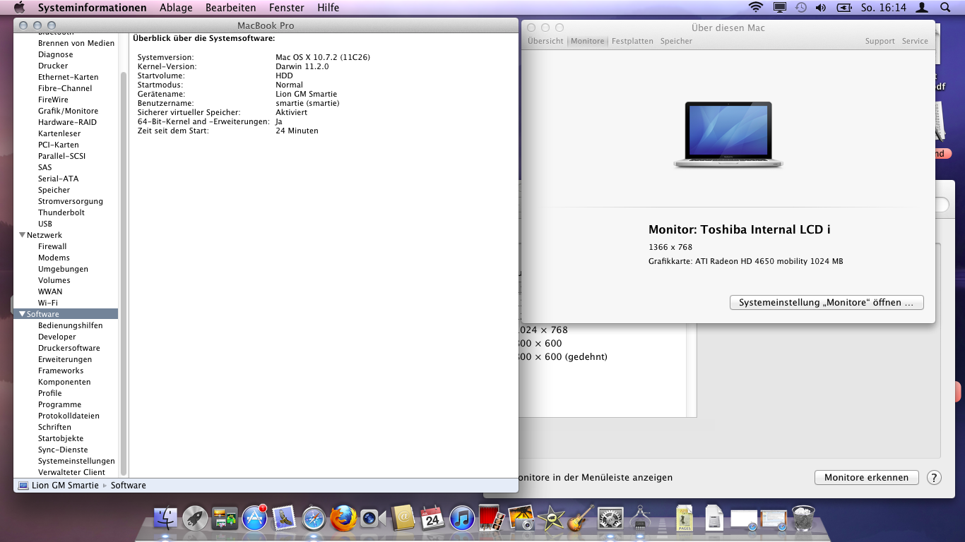

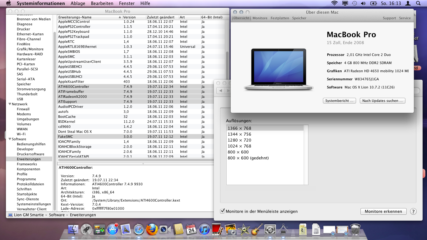

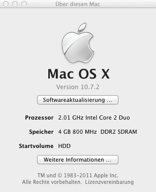

smartie77 Posted July 24, 2011 Share Posted July 24, 2011 OSX LION combo update 10.7.2 beta has leaked ( see google for imzdl ) . A second seed this last days came up, mainly for the newer iCloud b6. These kexts can still be used ( in any Lion version from 10.7 thru 10.7.2) It contains newer graphic kexts then in the GM/Appstore build. -- you can SAFELY use these in LION GM/AppStore 5A11 if you are only interested in the better graphics but want to keep the rest of Lion original until Apple has 10.7.1(2) ready for public. GM/Appstore 5A11 contains ATI drivers v. 7.2.9 These kexts here are v. 7.4.9 from the leaked "ComboUpdate 10.7.2" modded for Laptops that have 4650mobility with DeviceID 9480 and use the Shrike Framebuffer. QE/CI can be achieved with ATY_init in /S/L/E 32 and 64bit mode. SMBIOS + AppleGraphicsPowermanagement modded to make Laptop appear as a MacBookPro with ATI speedstep ( "powerplay" = silent fan ) working . SMBIOS.plist in /Extra, KEXT in S/L/E running perfectly in my Toshiba Satellite L500. Either 32 or 64. All have QE/CI and 1366x768 ...... LVDS SHRIKE 1366x768 MODDED (!) ATI LION 10.7.2 KEXTS : ATI4650mobility.shrike.32_64_v7.4.9_osx10.7.4_lion.beta.zip DEVICE ID 9480 + MODDED MACBOOKPRO ENTRY // uses iMac10,1 ati speed stepping (!) 10.7.2 GraphicsPowerManager for ATI 4650 only + compatible SMBIOS : MacBookPro_ATI4650mobility.OSX.Lion.10.7.2beta.ATIv10.7.4.zip compatible ATY_init for Shrike ( dont boot with GraphicsEnabler if you use this Kext ! ) : ATY_Init.kext.zip Link to comment Share on other sites More sharing options...

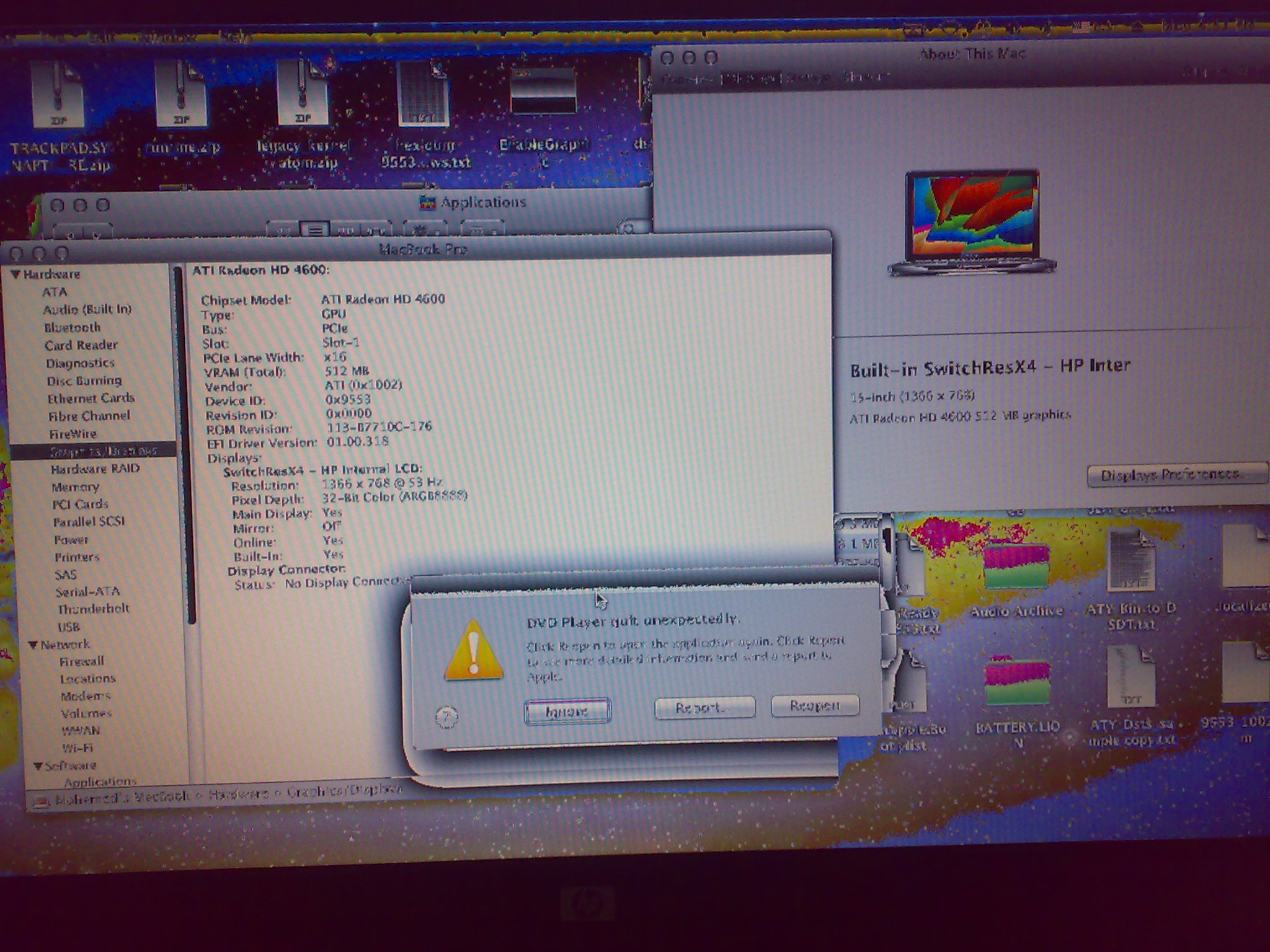

NemU Posted July 25, 2011 Share Posted July 25, 2011 i have now working with QE/CE but interrupted colors on internal LCD, i did EDID edit and it shows HP LCD i can change resolution by Xres, when try to capture the screen i only see the fuzzy color but i opened the file on windows i saw normal colors !!!! i toke photo with phone to asks you where is my mistake , please help me Link to comment Share on other sites More sharing options...
