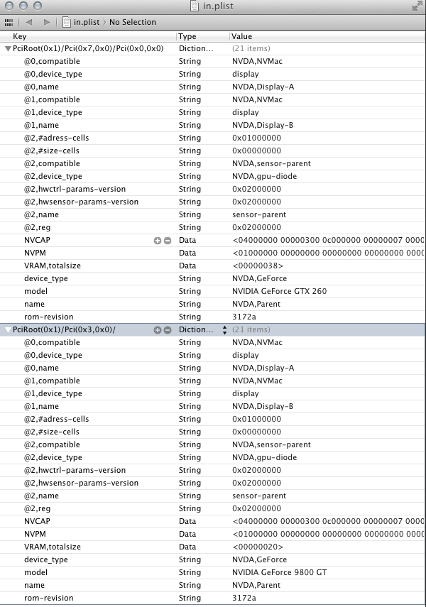

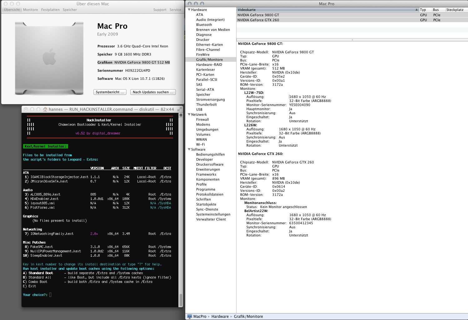

Hey Thank you for showing how to use 2 Graphic cards!
But i have a Problem with it: i can not Shut down my Machine! The fans simply continue to run...
I'm using a GTX260 and a 9800GT. i followed the desctription on the link in the first post. i Worked on the first try!
But i lost the ability to shutdown my machine!
Has anyone an Idea whats wrong there?
Any hint would be soooo great!
