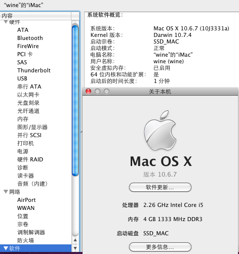

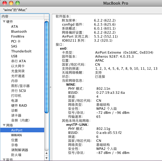

经历过一夜和一日近乎崩溃的试验,终于驱动了这个堪称史上最难搞的AR系列无线网卡。
AR9287(AR5B97)成功驱动的步骤,三个必要条件,缺一不可:
1. Mac os x 10.6.7系统。原版10.6.7安装,或者低版本升级10.6.7包都可以
2. Mac OS X 10.6.7 (10J4138)-Darwin 10.7.4内核。
替换方法:用小工具ShowAllFiles显示所有文件,把系统分区下mach_kernel先删除,然后复制Darwin 10.7.4内核过去即可,最后用ShowAllFiles隐藏所有文件。MAC变色龙EXTRA目录下的mach_kernel也一样替换。
注:其他版本的mach_kernel也可能正常驱动。
3. IO80211Family.kext for AR9287 10.6.7 (设备 ID为168C-002E,已经修改好,如果你的9287是其他ID,请自行修改)。用kext utility安装即可。

3 steps to make your ar9287 work fine in 10.6.7:
1. installed Mac os x 10.6.7 system.
Original 10.6.7 or upgraded 10.6.7 will be fine.
2. Mac OS X 10.6.7 (10J4138)-Darwin 10.7.4 mach_kernel.
Substitute the existing mach_kernel in the MAC OS system drive and Chameleon's Extra folder with this one. Use a small tool 'ShowAllFiles' to show the hidden mach_kernel. Delete it and copy the new one in. Then hide the files.
PS. Other versions of mach_kernel might work too.
3. install IO80211Family.kext for AR9287 10.6.7 with kext utility.
The default hardware ID of my ar9287 is 168C-002E and the kext was modified into it. Other hardware ID, you can modify it by yourself.
Done. Reboot and check it out.
PS: AR9287 is actually drived by AirPortAtheros9388.kext which is provided in MacBook Pro Software Update 1.4 (DL1382)
