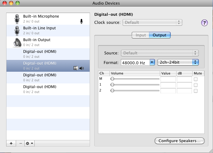

ksosx86. Posted April 4, 2011 Share Posted April 4, 2011 I wanted to start a thread dedicated just to overall support and solutions for this product to avoid any possible confusion or misunderstanding for new viewers/users looking for solutions for this product since the other K50 thread specifies it's just for a DSDT and info is a bit unorganized. The following should be all you need to run OS X Snow Leopard stable & fast on this laptop. I recommend using 10.6.5 or above with the following. The following has tested stable for me without KPs on 10.6.7 x64 (without Voodoo power kexts): 1.) I made a DSDT based off the new K17 BIOS dsdt.aml.zip it includes the following fixes/improvements: -Fully working DSDT graphics (HDMI output + analog) Disable/Remove G.E. or any graphics injectors when using this. -Modified HPET solution, based from Vista. No need for Disabler kext, supports native appleintelcpupowermanagement. -RTC,MUTE,ALIAS fixes (no need for forceRTC/legacy kexts) -Native AR9285 support (no need to use modified IO80211Family.kext with this DSDT to get working wireless) -Fully functional ALC269 audio via DSDT inject (see info below regarding ALC269) -Working Sleep without sleep enabler (Although it seems to break Restart though, hopefully I'll find a fix for that soon) -Update: This DSDT fixes the Shutdown issue, (thanks go to AlexKord for this fix) 2.) custom smbios.plist smbios.plist.zip -Pretty basic stuff, but this plist is necessary because you need to run this laptop as a MacBookPro5,3 for HPET to work right. (That may sound silly but trust me it's true) Besides if I'm correct that model identifier included macbookpros with the MCP79 chipset, same as the K50ID. Feel free to add any additional fixes to this smbios.plist... 3.) ALC269 Solution (It goes without saying that you'll obviously have to reinstall these kexts in the event of a system update) AppleHDA.kext.zipIOAudioFamily.kext.zip -You'll Need to use the modded AppleHDA and IOAudioFamily I've attached in conjuction with the DSDT for full ALC269 support. -Don't use any past forms of VoodooHDA, they'll conflict and are obsolete compared with this solution. -Both integrated and Line in mics work 100% -Full 24-bit audio support without glitches. 4.) HDMI audio Solution VoodooHDA.kext.zip -For this you'll need to use this custom VoodooHDA I worked up based on "VoodooHDA 0.261". -This is the only VoodooHDA that will work in conjuction with the ALC setup, unless you mod your own. -The solution isn't vectorized so I'm not sure how the 24-bit audio will perform under heavy Bass. -Make sure and select the second HDMI device for output, I posted a screenshot. -Note: Vectorizing may cause KP. -Note: Mac OS doesn't manage output control for HDMI audio solution, so you'll need Soundflower if you really want that option. 5.) Unlocked ASUS K50ID BIOS K50IDAS.218.zip -The following BIOS entitiled K18 unlocks all the advanced features of the laptop's BIOS. -Hopefully someone will find a BIOS option related to shutdown bug. (I haven't tested every setting.) -Also I found that this BIOS adds fan speed control & enabling of PCI-E 2.0 (Might add a bit of GPU perf.) 6.) You'll want to use the following method for the Realtek ethernet to avoid Kernel Panics with official Realtek drivers. RealtekRTL81xx_0_0_67_.pkg.zip 7.) Modded functionflip prefpane by prasys FunctionFlip_1.prefPane.zip (works great for assigning volume control since Fn keys don't work 100%, hopefully that will change.) Here's a few extra apps & kexts I use that you might find useful: SoundSource.zipLineIn.zipSoundflower.pkg.zipExtra_Kexts.zip(FakeSMC, VoodooBattery, EvOreboot, ApplePS2Controller & AppleACPIPS2Nub) Update (3-28-12): I'm sorry but I won't be able to do a Lion guide, I don't even have the laptop anymore *sold it for sandy bridge* I know I said I'd work on one but I just don't have the time, or interest in that anymore tbh....some of the work should carry over directly, best of luck with getting everything working for Lion sry I can't help. Link to comment Share on other sites More sharing options...

Jingu Posted May 22, 2011 Share Posted May 22, 2011 This is an interesting new method of enabling sound for the Realtek ALC269 combining VoodooHDA, patched AppleHDA and patched IOAudioFamily. For the first time my internal microphone is enabled on my ALC269. Can you give the edits you did to IOAudioFamily, so we can apply the edits to newer versions of the kext? I'm not a big fan of reusing old kexts in newer system updates. I prefer to apply the edits to each new system update. It ensures better compatibility. Thanks. Link to comment Share on other sites More sharing options...
