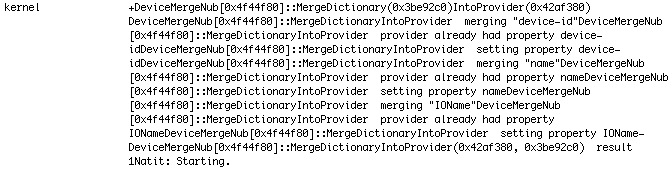

I find something strange in IORegistryExplorer.
It seem that all PCI devices are injected by the same infomation.
For example.
and I find this in Console.
Is the kext cannot be used with natit? :dice:
That's odd... it didn't do that here (I think).
I'll look into it.
For example.
Is the kext cannot be used with natit? :P
Sorry, I mixed up the way the USB family does it.
The proper way is the plist attached below....

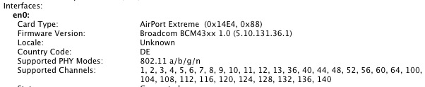

By injecting information,I got my graphic card enabled and make my wireless look like an AirPort Extreme Card.
Good job,Andy! :D

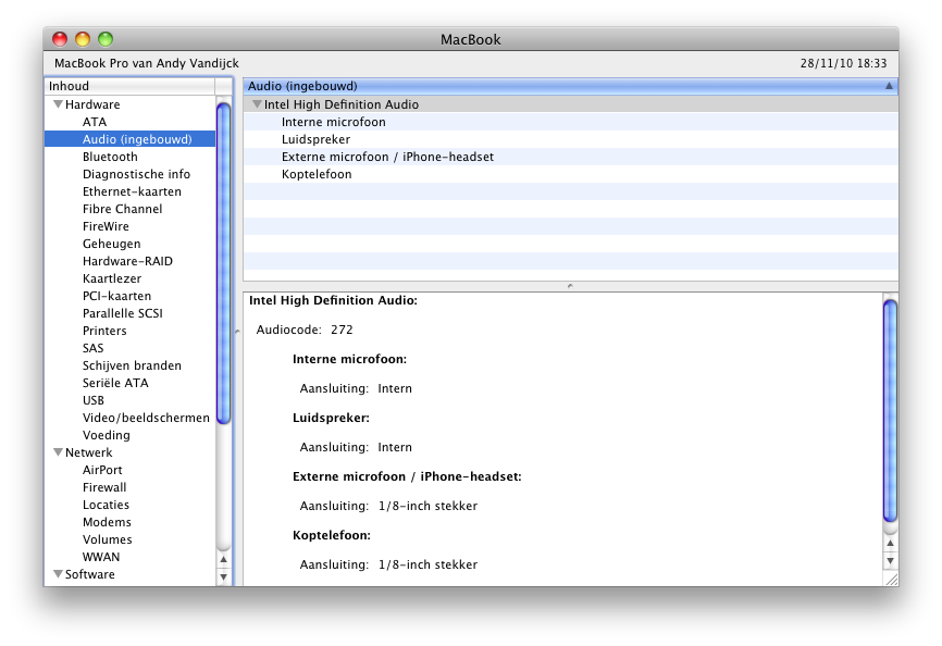

I've got another example.
This one matches on part of the class id.
It's a replacement for HDAEnabler in this case (audio injector).
Info.plist_audio_AppleHDA.zip

1. You must use only one injector but use the apple plist editor to set multiple IOKitPersonalities.
2. The injector performs on PCI devices only, not USB devices (use AppleUSBMergeNub for that).
3. The support will only be there for injecting information for AppleHDA + System Profiler (see picture)
