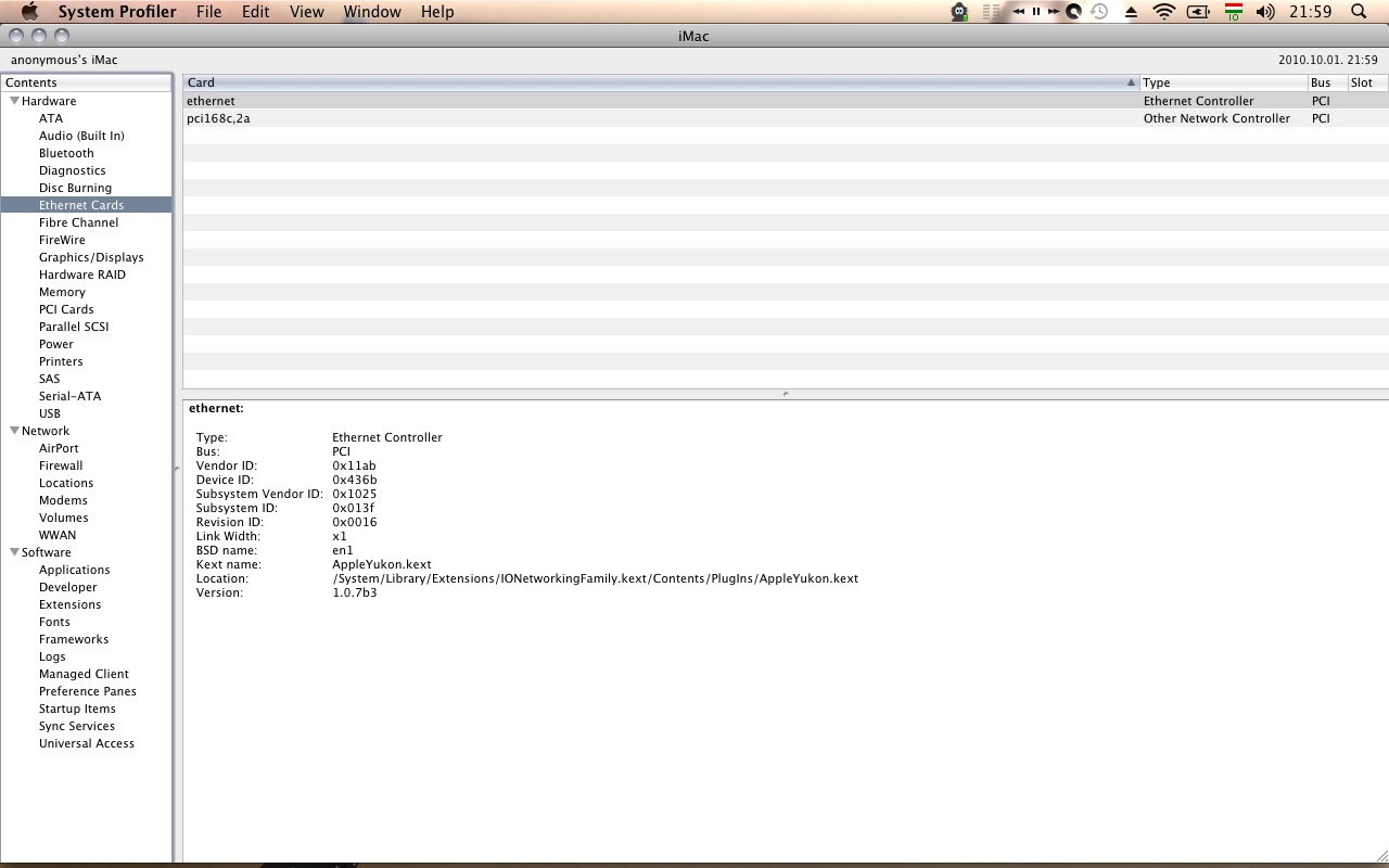

Hello! I have this LAN chip in my lappie, but when i injected the pciID in the Info.plist, it crashing always when i open the Network Preferences. Now i have found an working solution (maybe, i don't have wired LAN here and i can't test, but it not crashing... maybe... TRY, and pray!).
!!!! It require 32 bit mode (arch=i386)!!!!
You can get the driver here: http://dl.dropbox.com/u/844783/AppleYukon.kext.zip
You need put this .kext to the /S/L/E/IONetworkingFamily.kext/Contents/Plugins
Repair premission, pray, and reboot.Please, report back!

Sorry, I forgot to mention You need edit the plist in this kext like this:
IOPCIPrimaryMatch
0x436[color="#ff0000"]B[/color]11AB
and
Model
string>Yukon Gigabit Adapter 88E807[color="#ff0000"]1[/color]
I hope it will work for You now (but only in 32 bit mode). (I don't have any wired network here, this is why I can't test it. Please, report back!

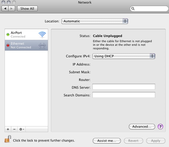

It's pretty sad, seems not work for me.
After use this driver, NIC can be recognized in Network utility, connection status seems OK, the status can change if I plugin or unplug the cable, MAC address also correct too.
But cannot get IP address via DHCP, I set the IP address manually, everything seems right, but I cannot connect to other machine in the network.
Try to ping any IP of network, it always request time out, and other cannot ping it too.
Also try to set the parameters manually like the connection speed or MTU etc., but no luck.
I set arch=i386 to boot my hacintosh, and I confirm that no errors when i issue the command kextload AppleYukon.kext.
My router is Buffalo wzr-hp-g300nh, I also tried to use a 100MB switch instead of router, still no luck.
