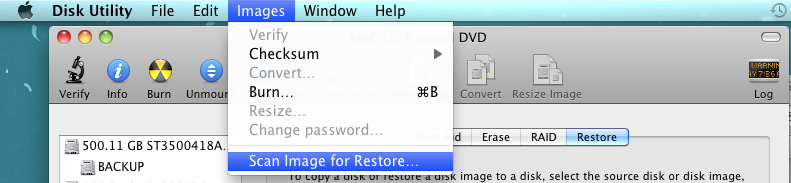

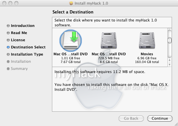

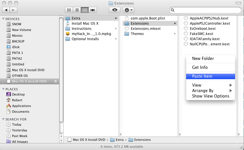

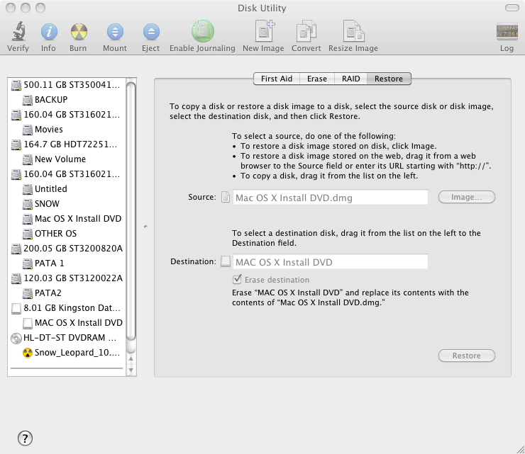

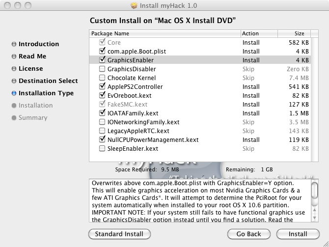

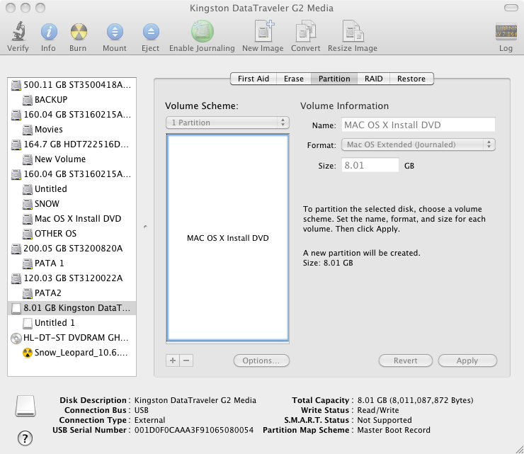

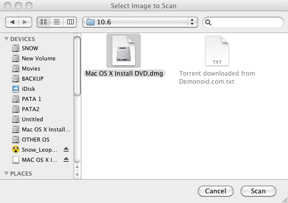

RoberT_XeS Posted March 20, 2010 Share Posted March 20, 2010 SNOW LEOPARD RETAIL 10.6.X FOR P5Q MOTHERBOARD SERIES AND OTHERS This guide should work for all ASUS P5Q Series Motherboards USB Method....MBR Support Included STEP 1: REQUIREMENTS If your Motherboard bios is not included in the link below then you can request Shamux or Smith@@ to modify Bios for you 1. Modified Bios : Here or Here 2. USB / Flash Drive: 8 GB or External HDD or a 8 GB Partition on you Internal HDD 3. Working Leopard 10.5 or any working Mac. If you do not have one then follow the guide here 4. SNOW Leopard Retail Image 10.6.0 (You can use 10.6.3 if you are installing myHack v1.1) STEP 2: FLASHING BIOS 1.You can find Modified Bios for P5Q Motherboards Here 2. Save the modified Bios File to USB Flash Drive or Floppy disk or on your HDD. 3. After reboot press "DELETE" to enter setup 4. Go to section TOOLS > mark ASUS EZ Flash2 > press Enter > press OK 5. Press "TAB" > Select a key "Down arrow" or "Up arrow" saved on a floppy disk or flash-drive or HDD and select the modified Bios file 6. Press �ENTER�. 7. Select "OK" > press "ENTER" 8. System will erase the old BIOS and will write the new one 9. And in 5 seconds will automatically reboot STEP 3: LOADING BIOS OPTION CHANGE THE STORAGE CONFIGURATION IN BIOS TO AHCI. (Please note that windows might not boot if you do not have AHCI Drivers installed on Windows. Please follow the steps here under AHCI Mode if you want to install AHCI Drivers on Windows) Also make sure that the Firewire option is Enabled in the Bios. Suspend Mode: S3 Also Enable ACPI 2.0 in the Bios if you are struck in (ACPI_SMC_PlatformPlugin::start – waitForService) while booting STEP 4: RESTORING RETAIL IMAGE FILE 1. Log into your working Leopard Machine. 2. Plug in your USB Drive 3. Open Disk Utility (FINDER > Applications > Utilities > Disk Utility) 4. Right click on the USB Drive and select Partition 5. In volume scheme select 1 Partition and name it as MAC OS X Install DVD 6. Select the Format as Mac OS Extented (Journled) 7. Now Click on Options and Select GUID Partition Table or MBR Master Boot Record and then click on Apply. (I prefer MBR) 8. Now its time to verify the Snow Leopard Retail Image you have 9. Click on Images Menu at the top and then select Scan Image for Restore 10. Select the Image File and then click on Scan 11. Now select the MAC OS X Install DVD (USB Drive) Partition and click on Restore 12. In the source select the image that you just scanned 13. In the destination drag and drop the USB drive named MAC OS X Install DVD 14. Now click on Restore. This will restore the SNOW Leopard Retail Image File to the USB drive STEP 5: VERY IMPORTANT 1. Now download myHack Installer 1.0.1 from here or here Thanks to Scott aka “Conti 2. Now run the file myHack_Installer_1.0.1.mpkg and then continue. You can also use new package myHack 1.1 3. Click on Change Install Location and select the USB Drive and then click on Continue 4. Now click on Customize and select the options as shown in the image below. 5. Once done please extract the RoberT_Xes_Kexts.zip file.(If you are using myHack 1.1 then do not replace FakeSMC) 6. Copy the kexts inside and paste it to USB Drive > Extra > Extensions (use only those kexts which you need. For kext information used in my pack....Click Here ) 7. This will replace the original kexts with my kexts 8. If the FakeSMC included in my package does not work for you then useFakeSMC 2.5 kext. 9. Now Reboot your System If you want Dual Boot with Windows 7 then you can do the partition as I did. Refer to my Parition style at the Bottom of this post. STEP 6: INSTALL SNOW LEOPARD 1. Reboot your Machine and keep on pressing F8. 2. This will give you an option to select Boot Drive 3. Select the USB Drive 4. Type in -x -vand then press Enter 5. Follow the instructions and you will get an option to select the Drive in which you want to install Snow Leopard 6. Run Disk Utility and then right click on the Drive which you want to erase and then select Erase. 7. Now close Disk Utility and then select the drive which you just formatted and then continue. 8. Now click on Customize and then unselect Language Translations and Printer Drivers. 9. Once done, restart the computer. Troubleshooting Steps (If you face any problem while trying to Install) While installing Snow Leopard, if you are receiving a kernel Panic then you can try the old modified Bios instead of the new ones. Enable ACPI 2.0 in your Bios if you are stuck in (ACPI_SMC_PlatformPlugin::start – waitForService(resourceMatching(AppleIntelCPUPowerManagement) timed out) and use FakeSMC 2.5 from here (Thanks to piromanneo for this solution) If you are getting Blank or Black Screen while trying to install because of your ATI Graphics card or some newer NVIDIA Graphics card then click here You can try to boot with -x -v cpus=1 if you are facing problems to get the installation to start Those who are having ATI Cards / Newer NVIDIA Cards and stuck in (ACPI_SMC_PlatformPlugin::start – waitForService(resourceMatching(AppleIntelCPUPowerManagement) timed out)...... or if you are getting a Blank or corrupt screen then please copy EVOEnabler.kext in to USB Drive > Extra > Extensions folder and then boot with -x or -x -v to resolve the issue STEP 7: MAKING YOUR SNOW LEOPARD BOOTABLE 1. Boot using your USB Drive 2. This time select the drive in which you have Snow Leopard installed, type in -v and then press Enter 3. Now run the file myHackInstaller1.0.1.mpkg and then continue 4. Click on Change Install Location and select the Drive in which you have Snow Leopard Installed and then click on Continue 5. Now click on Customize and select the options as shown in the image below. 6. Once done please extract the RoberT_Xes_Kexts.zip file 7. Copy the kexts inside and paste it to SNOW Leopard > Extra > Extensions (This time use only those kexts which you need. For kext information used in my pack....Click Here) 7. This will replace the original kexts with my kexts 8. Now Reboot your System Those who are not able to boot Snow Leopard using the myHackInstaller can try PC EFI 10.6 or Chameleon RC4 from here Even after trying the above steps if you are still not able to boot from the Snow Leopard Drive then follow the below steps 1. Repair the boot using Windows Vista / Windows 7 DVD and then boot into your windows or you can download PartedMagic Live CD and boot into Parted Magic and here open Partition Editor and give the Boot Flag to your Windows Drive and reboot 2. Now you will be able to boot into Windows. 3. Download Easy BCD 4. Install the software and then 'Run as an administrator' 5. Here click the Add/Remove Entries button 6. You can add Mac OS X and also Linux Entries here...save the settings and then reboot 7. Now you will be able to boot into Snow Leopard STEP 8: INSTALLING UPDATE 10.6.X 1. Download the update from http://www.apple.com 2. Before installing the update, please remove SleepEnabler.kext from Snow Leopard > System > Library > Extentions and also from Snow Leopard > Extra > Extensions 3. Now Double click on the update file and install the update 4. Reboot your Computer 5. Once done you can install the latest SleepEnabler.kext from here http://code.google.c...er/updates/list STEP 9: INSTALL DRIVERS INSTALL KEXTS USING Kexthelper b7 SOUND ALC 1200: http://www.insanelymac.com/forum/index.php?showtopic=161430 LAN Atheros L1E - ATL1E: http://www.insanelymac.com/forum/index.php?showtopic=140907 NVIDIA: http://www.kexts.com/view/170-videocards_(....6_(86-64).html. Use any one kext from here... ATI: http://www.kexts.com...php?do=cat&id=6 http://www.insanelym...howtopic=177112 For other Sound / Lan / Graphics Driver : http://www.kexts.com/downloads.php MY SYSTEM Motherboard--------------- ASUS P5Q Storage-------------------- 1 X 500 GB SATA /3 X 160 GB SATA / 1 X 200 GB PATA / 1 X 120 GB PATA CPU-------------------------Core 2 Duo E4600 2.4 Ghz OS-------------------------- SNOW LEOPARD 10.6.2 / Windows 7 RAM------------------------ Transcend 4 GB 800 MHz Graphics Card-------------- ZOTAC NVIDIA GeForce 9800 GT -GDDR3- 1GB MY PARTITION STYLE 1st Partiton : Windows 7 2nd Partition: Snow Leopard 3rd Parition: Retail Image (I Used a 8 GB partition instead of USB Drive) 4th Parition: Normal Extented NTFS Drive ASUS P5Q / P5Q PRO / P5Q C / P5Q L EM / P5Q VM / P5Q EM / P5Q L PRO / P5Q Premium / P5Q E / P5Q Deluxe / P5Q 3 / P5Q SE R / P5Q EM DO / P5Q SE / P5Q SE PLUS / P5Q SE R / P5Q L E / P5Q E WiFi AP / P5Q TURBO / P5Q PRO TURBO / Asus Maximus II GENE / Asus Maximus II Folmula / Asus P5Q PL VM EPU / ASUS P5B Series / ASUS P5K Series and many others Link to comment Share on other sites More sharing options...

RoberT_XeS Posted March 23, 2010 Author Share Posted March 23, 2010 AppleACPIPS2Nub.kext and ApplePS2Controller.kext are for my PS2 Keyboard and Mouse. AppleIntelPIIXATA2.kext, AppleVIAATA.kext and IOATAFamily.kext to make the PATA HDD (IDE) work ElliottForceLegacyRTC.kext is to resolve the CMOS Reset issue EvOreboot.kext is to resolve the restart problem OpenHaltRestart.kext to resolve the Shutdown and Restart issue SMBIOSResolver.kext ---- If your memory details are not properly shown in the Profiler So...the above kexts more or less resolves most of the issues......hence I used all those kexts.... If your system is working fine then do not install the kexts..... You should atleast have FakeSMC.kext, NullCPUPowermanagement.kext and IOAHCIBlockStorageInjector.kextfrom my package in to the Extra > Extentions folder if you want to install Snow Leopard Link to comment Share on other sites More sharing options...
