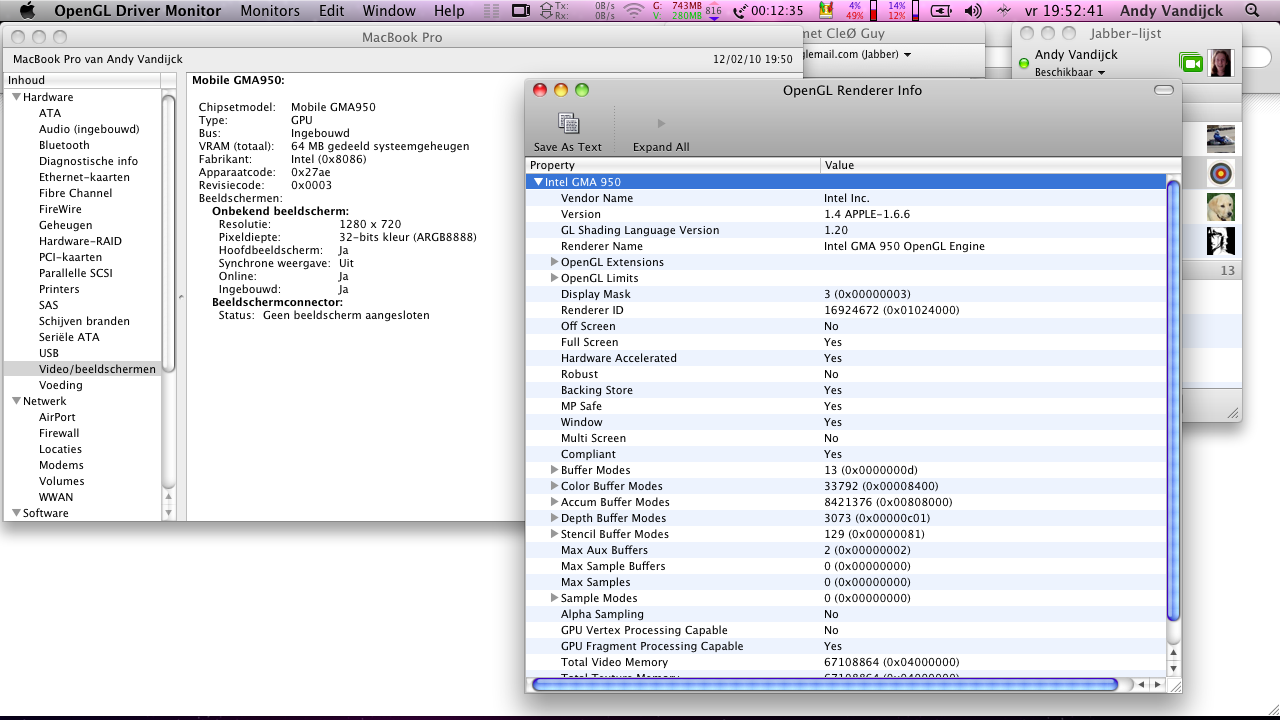

I've worked hard together with the Chameleon team to make this possible.
Big thanks go to Prasys for implementing the GMA GraphicsEnabler fix.
I devised the solution for getting CI/QE/OpenGL on the GMA card I'm using now...
I also fixed up some warnings in the GMA graphicsenabler.
This fix is for Snow Leopard 10.6.2...

This fix will give you native resolution (with patched AppleIntelIntegratedFramebuffer.kext for 27AE or stock one for 27A2).
And this will also give you Quartz Extreme, Core Image and OpenGL (with patched AppleIntelGMA950.kext for 27AE or stock one for 27A2).
Follow the steps described in the howto...

Hi Andy.
It works on acer travelmate 2490 with gma 950(27a2).
Proper resolution is patched, i know that my vga bios doesnt have 1280x800, (used i915resolution patch on linux, and now grub2 with 915resolution).
Removed all lines from dsdt for graphics, enabled graphicsenabler,removed grub2 resolution fix and it works. I don's see any difference between dsdt patch and yours boot file.
Does mirror mode works for you?
Could you build boot file without debuging?
Thnx.
Hi Andy.

Haven't tested out mirror mode as I don't have an extra display around...
Could you also please dump your VBIOS and post it?
It would be handy to check if there is an extra id needed for your card... (it reads chipset id from VBIOS...)
I will make a boot file without debugging as soon as everything matures a little (will be integrated also fully in RC5 when it comes out).

Now a fix for GMA950! (Or is there one?)
----UPDATE
Or am i being stupid as on the picture it says GMA950? I have a D945GCLF it has a GMA950 but has 945 in the name? Im very confused?
----UPDATE
Im quite sure it will work with my system as i have the same model of stuff as on the screen shot ima do it!
