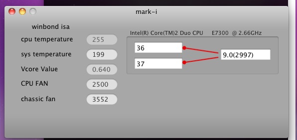

With your dl i get this (i think i must look in win which sensor chip i have, dont know Ep35-DS3)
The right side is correct, left not (sensor sure other type).
Unfortunately, currently only two chips supported. You can try to identify your chip with:mar_i.probing.chip.zip
