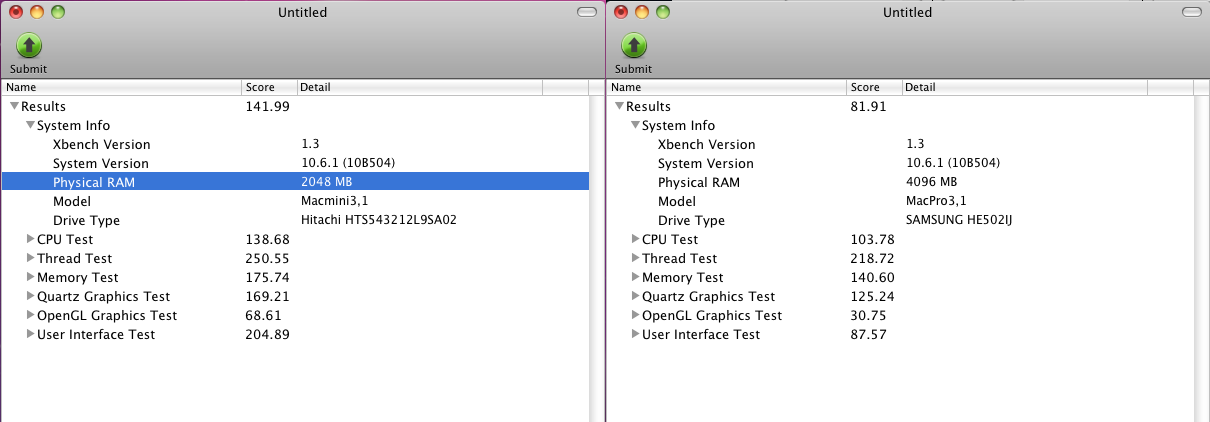

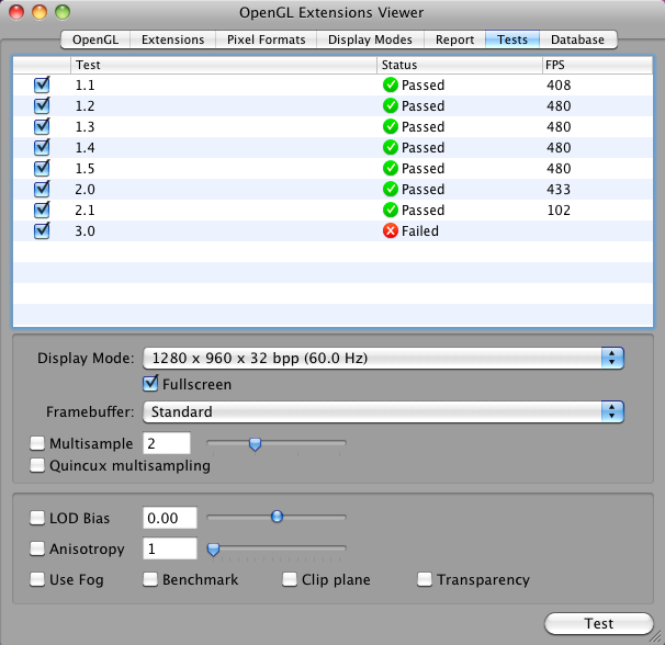

droodyf Posted September 29, 2009 Share Posted September 29, 2009 Hi all, I've done a Lifehacker-guide style install, retail Snow Leopard with the Chameleon boot loader and that's all gone fine. I'm using an E7500 (3.0ghz dual core) and a 9800 GT, and I have a suspicion I still have something to 'fix' with the install before its performing properly. Basically I'm being outperformed by my Mac Mini by a just-noticable amount. The Xbench scores are all over the place, the macmini essentially beats the hackintosh in every area except scores, whereas in actual usage the two machines feel very similar, but the Mini has a slightly quicker feel to the interface and scrolling around in bigger windows. I don't know whether this is simply because I'm running in higher res on the hackintosh, or whether something just isn't optimised as well as the Mini. Right now the mini is at 1680x1050 and the hackintosh at 1920x1200. Xbench and OpenGL results below (1280x960x32) for OpenGL as its the first resolution I can run the same on both computers) Is there anything obviously wrong that I've missed? This is the first hackintosh build I've done and I'm not 100% whether there's much post-install configuration to do. Link to comment Share on other sites More sharing options...

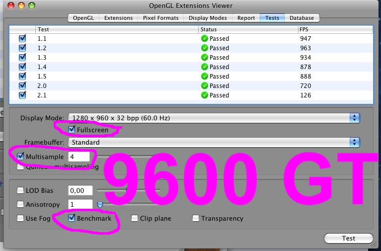

mitch_de Posted September 29, 2009 Share Posted September 29, 2009 ????? Comparing OpenGLExtensionsviewer Bench values i think right pic shows GT9800 , left pic MacMini. Cant see that the MacMini is "outperforming" the 9800GT !! For better gpu compareage set also (beside FULL SCREEN) Multisampling to 4* and Benchmark - GPU has much more to do, less CPU dependend values. Forget XBench for OpenGL benches - even an GMA950 is there faster than an ATI 2600 XT - unreal bench ! My 9600 GT (1280x960, 60 Hz (more HZ give a bit higher bench values!)) screenshoot attached (Fullscreen + Multi*4 + Benchmark) , your 9800 GT should perform up to 20% faster than mine. To the rest of XBench (CPU, Thread, User Interface - all three usable for benching, but geekbench is also much better) : Indeed your hackintosh is running slow . Have you checked if your CPU is running full speed (CPU-X) or do you have any speedstep installed - Xbench CPU & Co values are always bad if speedstep is aktive and throtthles. Use geekbench, also much better (newer) CPU + Mem Test. Here my Values: E7400 , at 3.0 GHZ (by FSB+ to 333, Multi- to 9*) , 1066 DDR2 RAM http://browse.geekbench.ca/geekbench2/view/152423 Compare especially Memory Speed - sometimes your memory speed may be bad by wrong bios settings (no OS X problem, set it up in the bios) Link to comment Share on other sites More sharing options...
droodyf Posted September 29, 2009 Author Share Posted September 29, 2009 Oh sorry, yes, I meant to say with OpenGL testing it was only the 2.1 mark that the Hackintosh lost, which was surprising given how fast it was in the others. Thanks for the your suggestions about clock speed / ram timings - I'll get these checked out and see if I find anything. So far I've used the motherboard auto discovery results, which initially put my CPU at 2.13 ghz (8x multipler) but I could set it back to 11x to get 2.93 without problem, so maybe its got the ram timings all wrong as well. I'll get Geekbench and try that now! Link to comment Share on other sites More sharing options...
