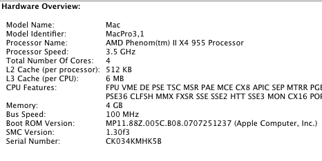

evil666 Posted September 2, 2009 Author Share Posted September 2, 2009 UPDATE:: Ok since this subject has pretty much been completed I am just going to put everything I have done to be successful. Specs I have M4A78T-E mother board AMD Phenom II x4 955 Black Edition Processor 4 gigs of gskill ram Nvidia GeForce 9500 GT Download and burn iDeneb 1.6 light 10.5.8 Make sure you have your Sata DVD Drive and Sata Hard drive plugged into sata ports 1-4 on mobo otherwise they won't be recognized by disk. When disk boots press F8 and use the following commands -v -F cpus=2 fsb=200000000 maxmem=4096 <-- this maxmem will change depending on how much ram you have, for example 1 gig =1024, 2 gig=2048, etc. When it boots make sure you format the hard drive using disk utility on disk. Make sure you use extended journal option when formating. Name your image something like OSX86. After formatting the drive should now show up and you should be able choose that disk for installation. Next step is to choose customize option right before install. This is what I chose to have an successful boot after installation remember this is for my cpu and mobo: Bootloader Chameleon v1.0.12 Kernel 9.5.0 Kernel Voodoo iDeneb x86 Essential Patches AppleDecrypt -AppleSMBIOS Patched AppleSMBIOS 1333 Mhz Disabler DSDT Patcher TimeMachine fix OpenHaltRestart AboutThisMac fix SystemProfiler fix Fix AppleHDA 10.5.6 CPUS=1_fix Firewire Remove idlehaltFix IOPCMCIAFamily SD/SDHCI Drivers IOUSBFamilyfix Mouse Lag Fix Seatbelt fix Drivers -Audio AppleAzaliaAudio VoodooHDA -Chipset AppleATIAATA AppleNForceATA ICHx Fixed JMicronATA SAS SiliconImage3132 VIA/SIS/Marvell/Uli -Network None due to the fact it does not have any drivers for my NIC -Video All nvidia After choosing those go ahead and start installation. After installation is done reboot. When it restarts hit space bar when you see chamilion bootloader countdown. Then type the following cpus=2 fsb=200000000 maxmem=4096 When the OS starts up navigate to library/Preferences/System Configuration Then make a backup of com.apple.Boot.plist and make an additional copy of it to so you can edit it. Lets edit it looks like this below. <?xml version="1.0" encoding="UTF-8"?> <!DOCTYPE plist PUBLIC "-//Apple//DTD PLIST 1.0//EN" "http://www.apple.com/DTDs/PropertyList-1.0.dtd"> <plist version="1.0"> <dict> <key>Kernel</key> <string>mach_kernel</string> <key>Kernel Flags</key> <string>idlehalt=0 cpus=2 fsb=200000000</string> <key>Timeout</key> <string>5</string> <key>device-properties</key> <string></string> </dict> </plist> save it and move it over to library/Preferences/System Configuration and overwrite the one in there. It will ask for your password to overwrite. This is done so you no longer have to type cpus=2 fsb=200000000 anymore up on bootup. This way its all done for you. Next if you have the same mobo i have, your NIC won't be working so perform the following: Download the attached file below Extract it and copy the files to a usb stick so you can copy this over to your osx86. Then run terminal Applications>Utilites>Terminal; Run Terminal I copied the folder that was extracted from the zip file to my desk top and renamed it driver just for ease. In Terminal type in cd <path to the extracted folder> e.g (cd desktop/driver) Then hit Enter. Type in sudo sh installrelease.sh Your NIC is now installed. Well thats it. Thanks for all those that helped. PS. Audio driver still need to be tweaked a tad but audio works, just the volume knob does not successfully change volume. AttansicL1eEthernet.zip Link to comment Share on other sites More sharing options...

evil666 Posted September 9, 2009 Author Share Posted September 9, 2009 2nd post above has been edited with full details on how to install iDeneb 1.6 light 10.5.8 with my specs. I hope it helps all the noobs cause we need all the help we can get. If any one was to use it as a tutorial feel free. Any comments or tips go ahead and post. Link to comment Share on other sites More sharing options...
