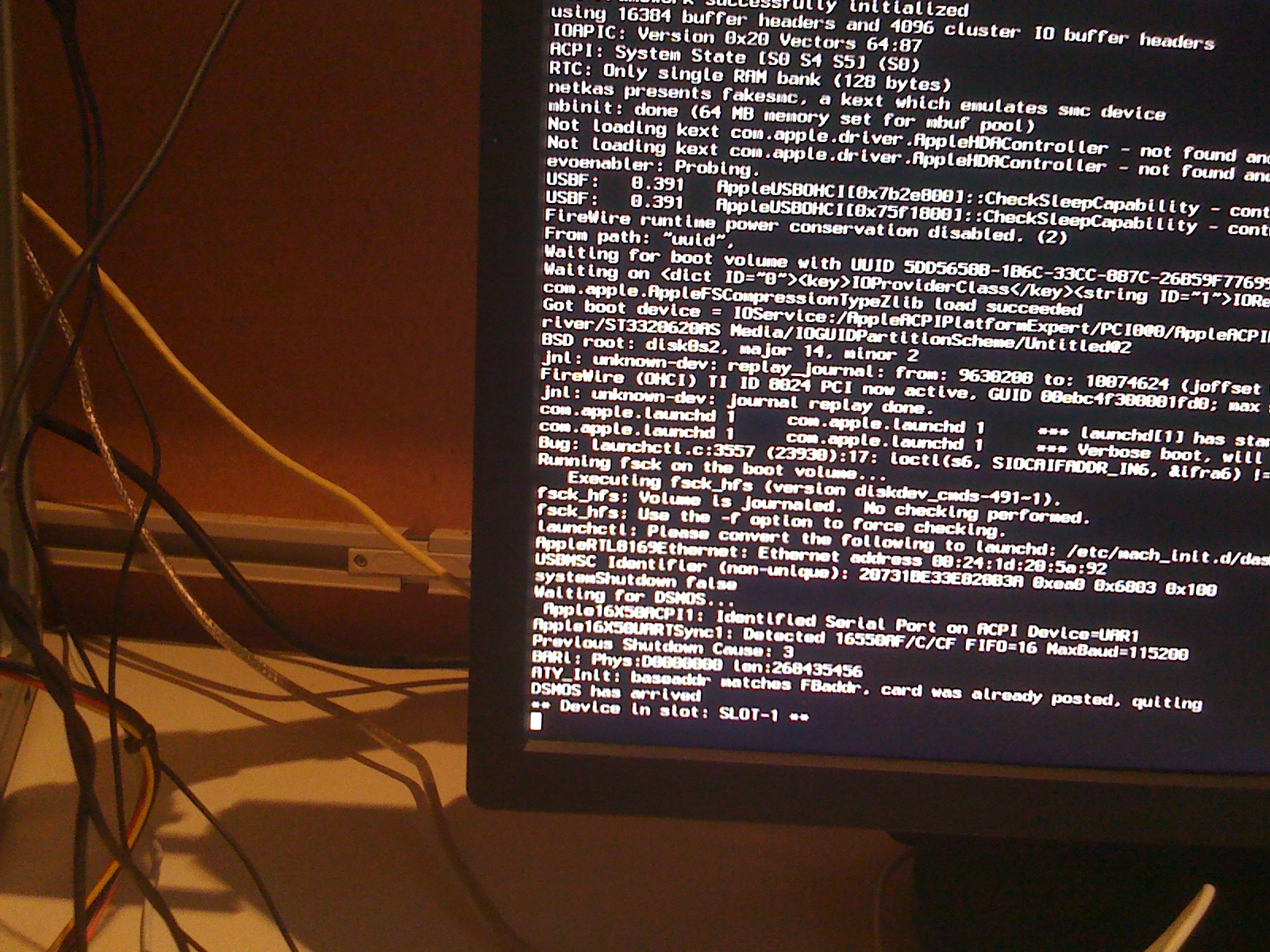

Even after adding the EVOenabler I am still stuck at the gray screen with no spinning clock.
ATI4800Controller did not need editing because the device ID was correct.

Here is the verbose boot screen. You can see the ATY-init kext load and then there is a message about a base address and then the screen goes and stays gray. Any ideas?
Could you list what ATY_init kext are you using for the 4870?
Do you have Natit installed?
Are the ATI2000 kexts all stock from 10.6?
My DSDT file seems good but I have not added the graphics string to smbios.plist�€â€is this necessary.
A setp by step guide or a list of the required kexts would really help. Been at this 2 days on and off!
try to remove the aty_init.kext.
you just need the 10.6 ati4800 and ati2000 kext with the evoenabler in /extra/ext not /s/l/e
Thanks Matty, that did the job.
