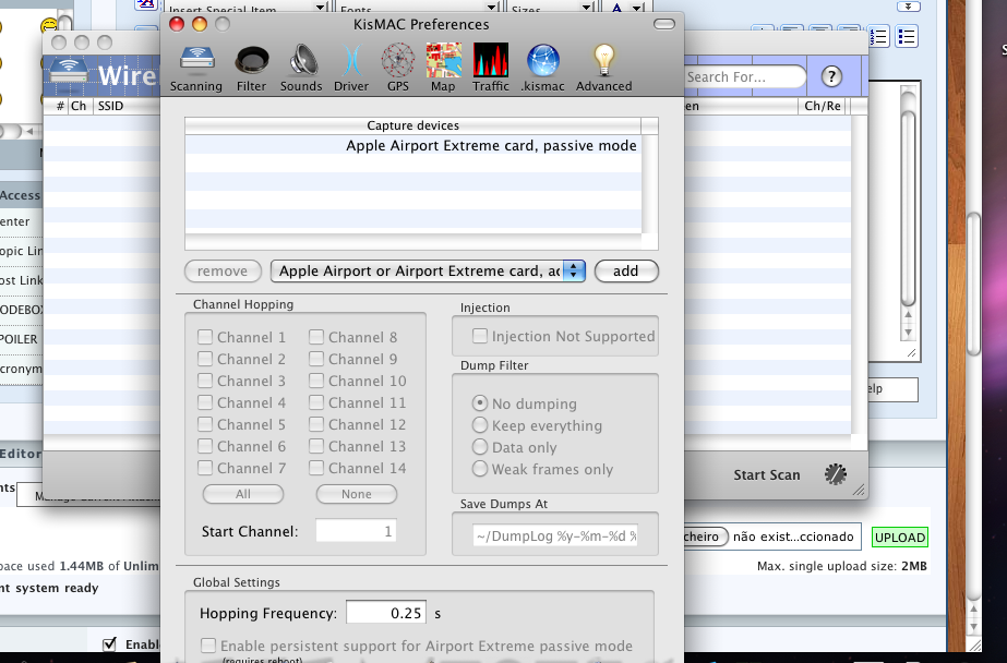

WinSucks_4ever Posted August 6, 2009 Share Posted August 6, 2009 do you download that app?? Thats normal AirPort cant find any networks so with that app will find it for you Download KisMAC Wireless Scanner Atheros "you need this app because airport dosent scan by it self if someone find it how to work I will be thankfully then open it befor you anyfing go to Wireless Scanner menu slect preferences then Driver tab select Apple AirPort Extreme Card Passive mode and click add" One more thins do you have DualBoot?? If you have make sure that you have the wireless card turned on!!!!!!!! Link to comment Share on other sites More sharing options...

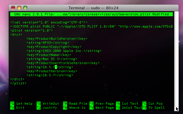

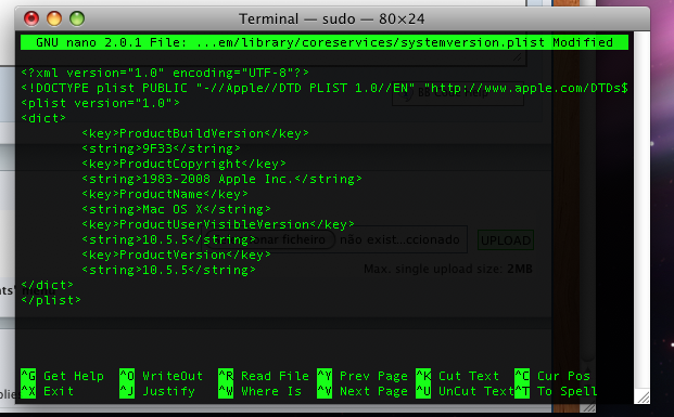

WinSucks_4ever Posted August 8, 2009 Share Posted August 8, 2009 Ok I think I found the solution! This will take a little of work! Firt install This Update Has I seen U have the 10.5.7 of Mac OS X to do this update you must have the 10.5.5 version. You dont need unistall the update, lets cheat the install program to make it recognise as 10.5.5. Open Terminal and type: sudo nano /system/library/coreservices/systemversion.plist (hit enter) change the values 10.5.7 to 10.5.5 change all the values you found. Install that Update CAUTION!!! This will delete the Atheros Driver so backup the IO80211Family.kext in the Extensions Folder!!! Make a copy of the file! Next install the Update, in the end DONT REBOOT DONT CLICK ON REBOOT BUTTON!!!!! Install the backup of the IO80211Family.kext and open terminal type sudo -s (press enter, this will ask you to type your passrd type and press enter) then chown -R root:wheel /System/Library/Extensions/IO80211Family.kext (press enter) chmod -R 755 /System/Library/Extensions/IO80211Family.kext (enter again) touch /System/Library/Extensions (and enter) now you can reboot Lauch Wireless Scanner.app and try to scan. Keep trying! Link to comment Share on other sites More sharing options...
WinSucks_4ever Posted August 8, 2009 Share Posted August 8, 2009 like this into this to save changes press CTRL-X Then Enter and Enter again Link to comment Share on other sites More sharing options...
Bassy Sweeeeet Posted August 8, 2009 Share Posted August 8, 2009 I tried the above and it KisMAC just doesn't want to start? I click Start Scan and it loads the Driver then it does nothing?! Justs goes back to where i press Start Scan: I do have the correct driver chosen!: I am running iDeneb v1.4 (updated to 10.5.8). Atheros AR5007EG: Dev ID = 168C Ven ID = 001C And in the info.plist it has my card listed already so it should work? <string>pci168c,1c</string> And The Wireless is Detected so...? Here is Information about my Wireless card: It shows the Airport icon yellow in System Prefs: Here is what i get when i run ifconfig en1: Using the DPCI Manager I get this information: I hope this is enough information/screenshots to let you know where im at =D Please find out whats going wrong please I have been trying to get this to work for over a year and some nock off attempts made me get it work (even in 10.5.8!!!) but then after reboot it all fails =[ Although my ethernet works, i want to get my wireless working so i can be mobile with my laptop Oh btw every time i boot i get Kernel panic, so i try your method and boot with Single User Mode (-s) and then manually load the IO80211Family.kext and then exit it (to boot up), then i can login. I am running the bootloader Chameleon RC2. I am dual booting Mac along side Windows 7 RC1. Thanks - Bass Link to comment Share on other sites More sharing options...
WinSucks_4ever Posted August 8, 2009 Share Posted August 8, 2009 I tried the above and it KisMAC just doesn't want to start? I click Start Scan and it loads the Driver then it does nothing?! Justs goes back to where i press Start Scan: I do have the correct driver chosen!: I am running iDeneb v1.4 (updated to 10.5.8). Atheros AR5007EG: Dev ID = 168C Ven ID = 001C And in the info.plist it has my card listed already so it should work? <string>pci168c,1c</string> And The Wireless is Detected so...? Here is Information about my Wireless card: It shows the Airport icon yellow in System Prefs: Here is what i get when i run ifconfig en1: Using the DPCI Manager I get this information: I hope this is enough information/screenshots to let you know where im at =D Please find out whats going wrong please I have been trying to get this to work for over a year and some nock off attempts made me get it work (even in 10.5.8!!!) but then after reboot it all fails =[ Although my ethernet works, i want to get my wireless working so i can be mobile with my laptop Oh btw every time i boot i get Kernel panic, so i try your method and boot with Single User Mode (-s) and then manually load the IO80211Family.kext and then exit it (to boot up), then i can login. I am running the bootloader Chameleon RC2. I am dual booting Mac along side Windows 7 RC1. Thanks - Bass Ok try THIS APP Its the same as Wireless Scanner.app Wireless Scanner is based in KisMAC, but more stable. Link to comment Share on other sites More sharing options...
Bassy Sweeeeet Posted August 9, 2009 Share Posted August 9, 2009 Right ok i tried doing that but KisMAC just freezes when i try to load it, i click start, it loads the driver and then does a really slow scan basically crashing the system until i click stop scan. I noticed whilst it was like that the airport icon was active: I also attempted a go from running KisMAC as root but that didnt work either: Is it me or is it saying 1603:10b ??? :S Maybe we can add that to the info.plist?? like: <string>pci1603, 10b</string> and if that dont work we can try <string>pci10b, 1603</string> Because i noticed that sometimes when their backwards it works? From my previous screenshots im not sure why DPCI recognizes my card as an AR5006EG when it is actually AR5007EG?? And also system profiler thinks my card is (168C, 428) When it really is (168C, 1C)?? Thanks, happy to try other stuff EDIT: I noticed that i cannot turn off the Airport, i click turn off, it stays highlighted for a while then remains turned on? :S EDIT 2: KisMAC is now scanning after changing the info.plist in AirportAtheros.kext to: <key>IONameMatch</key> <array> <string>pci1603, 10b</string> <string>pci168c,1c</string> <string>pci168c,428</string> </array> But it doesn't find no networks??? :S EDIT 3: YES!!!!!!!!!!! I noticed something weird about <string>pci1603, 10b</string> so i changed it to <string>pci1603,10b</string> so there was no spaces, installed it with kext helper, repaired extension permisions, clear extension cache, then touched extension folder and restarted. I login, open KisMAC and bam! wireless networks appeared: And i am now connected to a WPA secured network =D: EDIT 4: I noticed that when i turn off Airport and turn it back on i cannot find no networks until i run KisMAC again? EDIT 5: I restarted and it doesn't work no more KisMAC doesn't want to start, and Airport cant turn off so maybe thats a connection?? Link to comment Share on other sites More sharing options...
